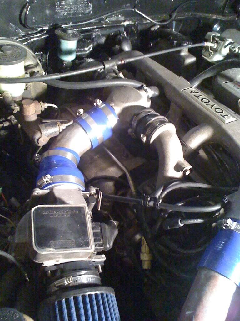

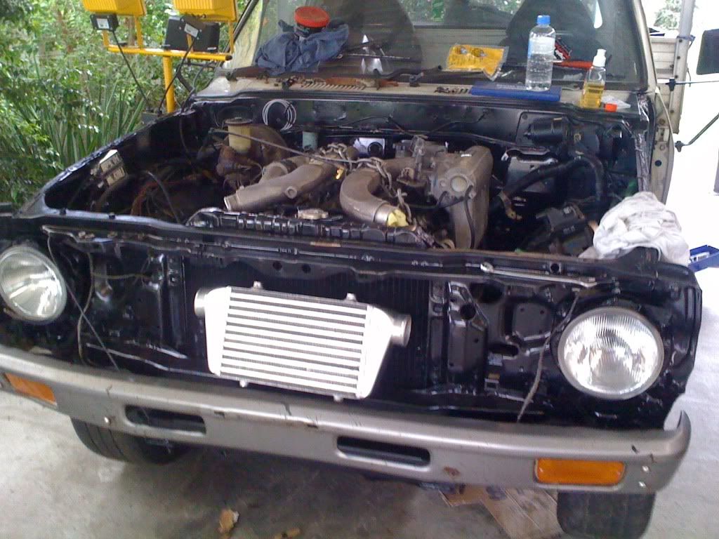

    just a few pics of the progression of the conversion..
    i have the engine/gearbox bolted in now.
    have to do : intercooler piping, radiator pluming, pwr steering lines, alternator wiring, ign/fuel wiring, move battery to other side of engine bay, install seats and shorten tailshaft with new yoke thing on the end for new gearbox.

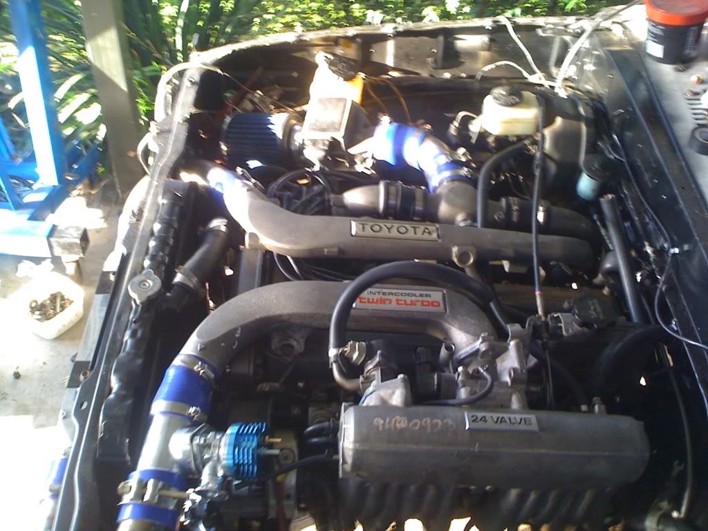

    Default Re: 1g-gte into Hilux - ADDED PICS OF PROGRESS
    oil fitting to get rid of the stock oil cooler for the oil filter which didnt fit
    i fully did the front end up as well, doing ball joints, shocks, disc brake conversion.
    radiator had the outlets moved to suit the thermostat housing
    engine in

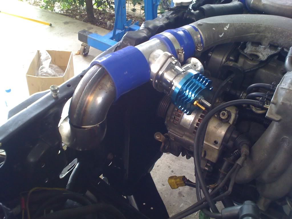

    intercooler piping sorted
    dodgy cheap arse bov from the states, only got it becuase it came with the adapter pipe

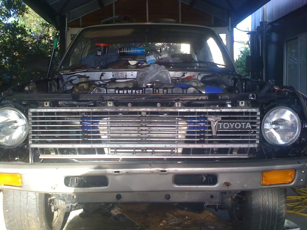

    grill on, fit like a glove after removing small plastic mounts bits in the middle

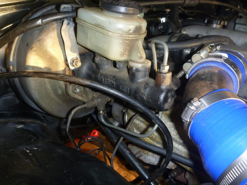

    a MX83 cressida master cylinder fitted, gives more room for the pipe to go into the turbos as the front brake line output goes up instead of into the engine

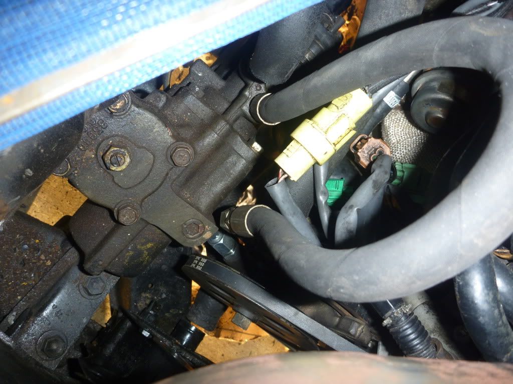

    also did a power steering conversion and used a MX83 cressida pr steering hose and one off a 4 runner for the low pressure side.
    another one of the master cylinder.
    so thats about it for now (after a day of panic becuase i sliced my hand open on a piece of steel and had 3 stitchers on my index fingers knuckle)
    need to get starter motor wired, alternator and the 3 wires for the ecu to get the thing fired up!!
