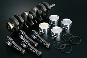

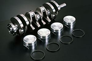

    its not cheap.......... 2188cc out of the box..... stroke 92mm, bore 87mm
    http://www.junauto.co.jp/products/cu...html?en#CK-3SG
    just get custom pistons made for 3SGE use
