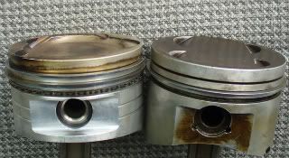

    The pistons in my original real low compression engine are ROSS as they have Ross forged into the underneath of them,
    but they worked out to around 7.8:1 ratio with the ST head.
    They were in the engine in the car when I bought it, and are probably 10 years old now since the car was first built, (but have spent the last 5 years sitting in the garage)
    here is a pic against an AE101 GZE 8.9 piston.

    ok am I seeing things or does that have valve recesses for both 16 and 20V?

    Quote Originally Posted by Sam_Q View Post
    Your seeing things.
    the one on the right is obviously a 16V one,
    and the one on the left has 3 one one side for the inlet and 2 on the left for the exhaust of a 20V.
    Exhaust cuts in a 20V and a 16V piston are in different places.

    that aftermarket piston is a completly different design than my ross ones.(ure ones look nicer)
    I spoke to the rep directly when he dropped of some parts and he said my pistons are 100% made by ross and the design was based directly on the stock 20v silvertop piston.

    well that might settle it then. Your right about them being based off stock, its justthe stock design minus the dome and thats it. The 16V series is different though they are like a bird bath
