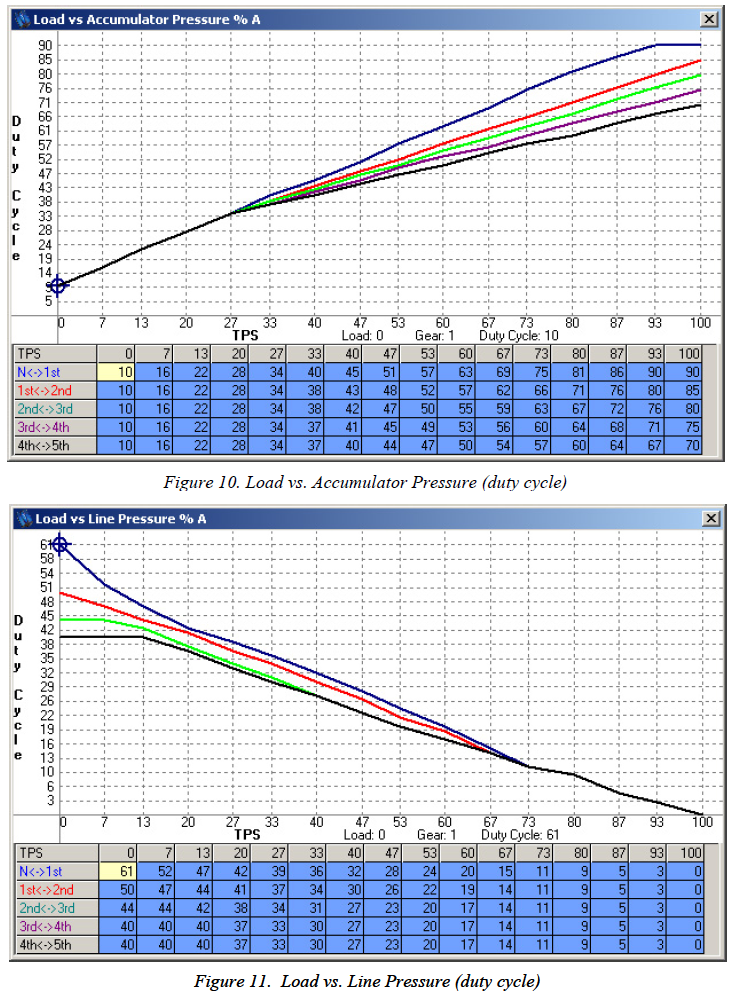

    Or another option would be make a controller for the two extra solenoids in the 2JZ box (SLT, SLN)...! (Or buy a controller like PCS... not that cheap tho...)
    You can see that they are just PWM vs TPS pretty well... This is more work than just fitting the other valve body tho (If MV say that will work)
