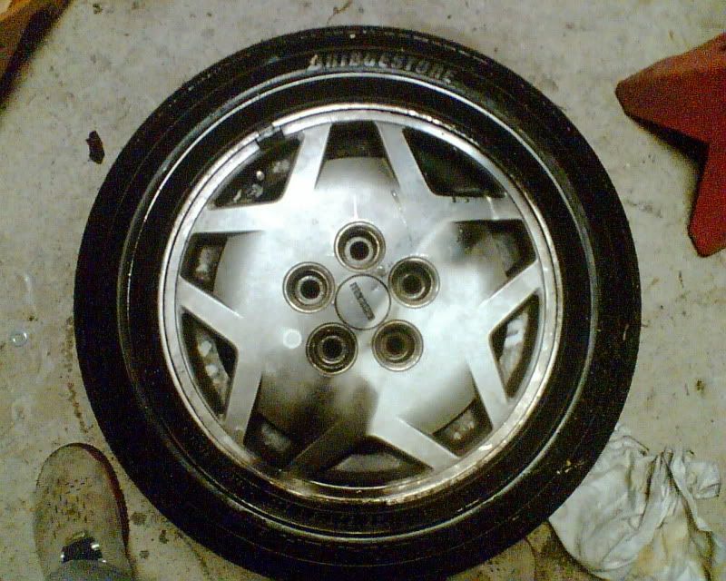

1989 MX6 Turbos have 5x114.3 stud pattern and are 15's. I have a few wheels......
I dont know the offset or width.....
I guess I could go check for you.......
I will be back...
Pretty ghey looking wheels though, but so were the car they were on![]()
just checked, The tyres on it are 195's and they look like they could take alot wider. 215's maybe 225's??
Alloy wheel 6" +42 offset
Proberley not what your after....
