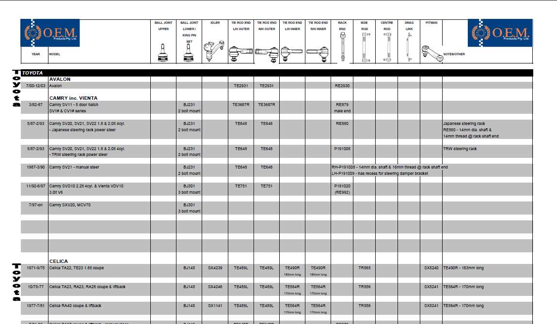

    This is an old thread but since it just got a revival here is the long and Skinny of the Classic Celica Steering parts in question. Most parts lists are incorrect which is not surprising since most people don't realise a TA22 is not a TA23 or an RA23. The guys at OEM however have the best listing I have ever seen, cause its actually correct (if you ignore the TE23 bit) !
    Thats Page 113 of the Listing. The full listing can be found here:
    2005 PAJA Listing
    yes I downloaded it and re-hosted it so it doesn't get "updated" and lost forever.
    TA22
    Idler - SX4239
    Pitman Arm - SX5240 or 555 Brand SX1240 - (130mm long)
    Outer Tie Rod End - TE489L
    Inner Tie Rod End - TE490R (183mm Long)
    Lower Ball Joint - BJ145
    TA23, RA23, RA28
    Idler - SX4246
    Pitman Arm - SX5241 (140mm long)
    Inner Tie Rod End - TE564R (170mm long)
    As you can see the TA22 does not share many bits with the other Classic Celica's. But at least this way you will be hunting for the right parts !
    As a note all the aftermarket company's generally use the same part numbers but the 555 brand use a different part number for the TA22 Pitman Arms, instead of SX5240, they are SX1240 - either part is very hard to come by.

    The OEM catalogue looks identical to the RoadSafe one - same font, same pictures, same shadings. Didn't check the pitman arm part numbers as the RA units are easy to get... (and I don't have to worry about snub nose Celica parts )
    If OEM are still stocking idler arms though, I am all ears.
