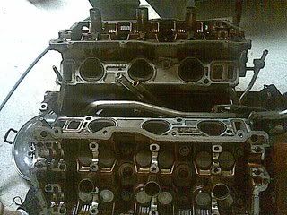

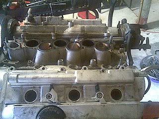

    Jul 2008
    288
    Default Re: 3vzfe inlet manifold removal & repair manual
    not sure if these help but anyways
    all sorted guys, ive managed to get the manifold off and ive found an engine manual, let me know if you want it, pm me your email and i shall forward it
