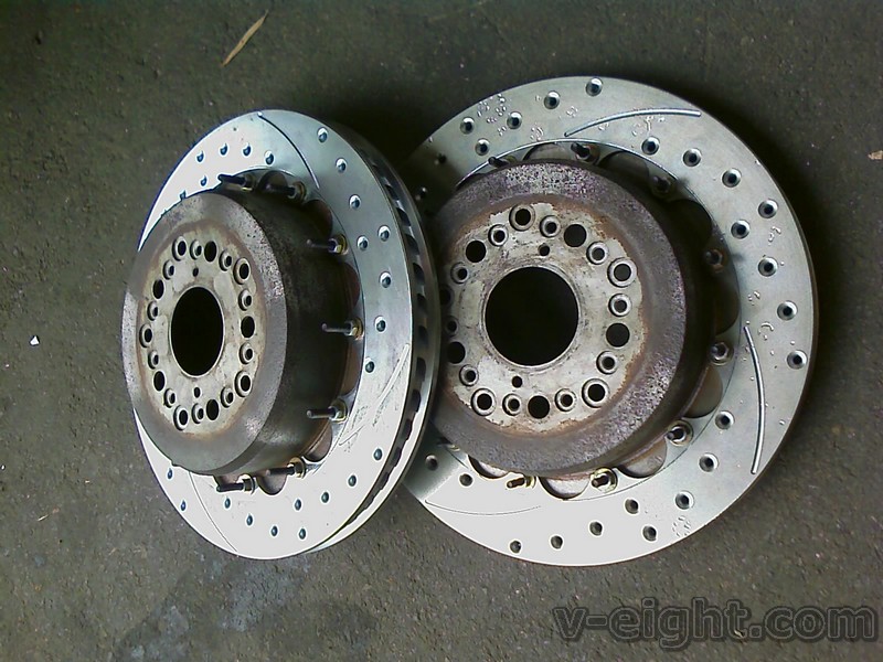

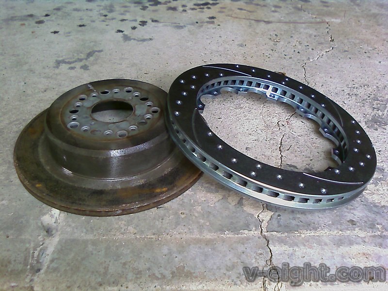

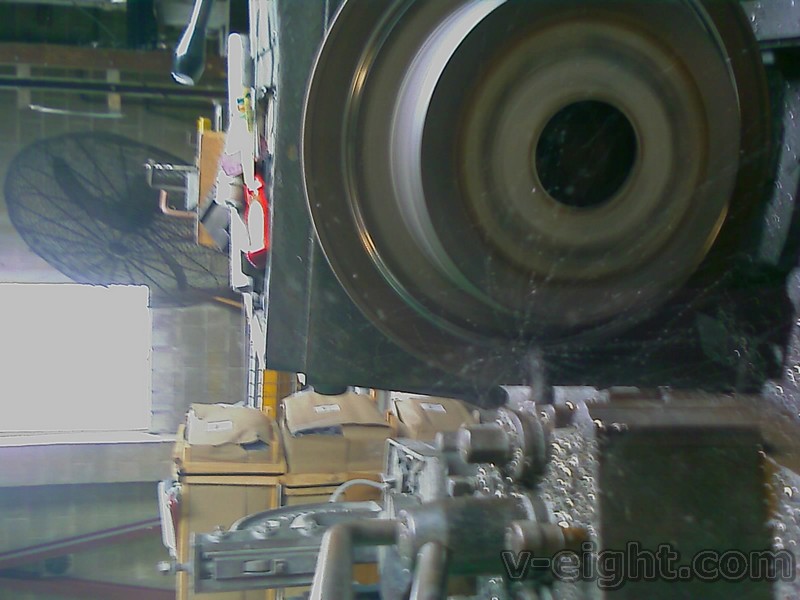

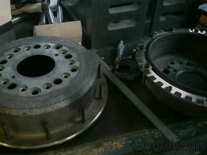

    machine the original disc down to use as the hat and fit an after market rotor to it?
    Im not a big fan of the idea personally but sometimes its hard to come up with better solutions on a budget.
    Or custom make the hats and get them hard anodised to avoid excessive wear, but its going to wear regardless.

    machine a new hat, like TRR suggested, but machine it out of 4140 steel to avoid wear problems with the handbrake. 4140 will also be plenty tough enough to handle bolting to the outer rotor
