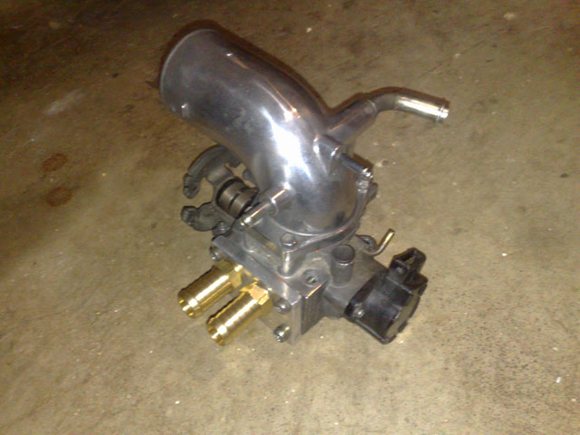

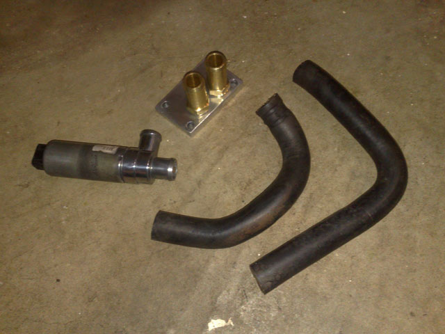

    Default Re: ISCV alternatives
    This is what I've done for my 4agze...
