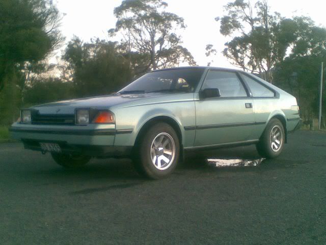

    All done they fit, and suit the car well, need to lower the front about 30mm.
    cheers for all the advice everyone

    185s......dont laugh
    there's no sidewall bulge lol
