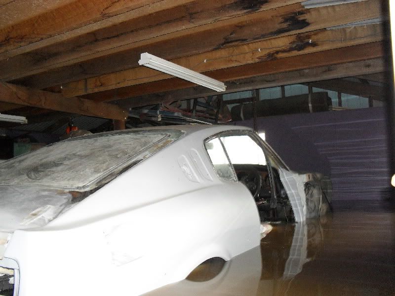

My advice is just get it dry and clean as soon as possible. If that's dirty water you will get sediment deposited in all the bits you can't see. Dirt traps mousture and rust starts. Let it dry and then use an air gun to blow out sills etc as best you can.
