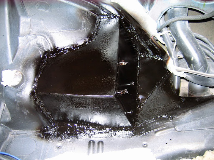

    But seriously..
    Did I mention I got a sponsor for the 6 hour for brake pads? I got some QFM pads from GSL rallysport in return for a sticker on the car. They also supplied an adjustable swaybar for a very good price.
    I've fitted a new swaybar as the existing one was kissing the sump under hard braking. So I got an AE86 whiteline adjustable which fits good and heaps of clearance.
    I cut out some of the rear floor and boxed my surge tank in and mounted the hiflow pump under the car so no more fumes.. I didn't feel I could be out on the track for an extended period of time without passing out from the smell.
    I have a small leak on my sump where i've welded the wings on.. So plan to pull the sump off and fix that.
    Also the exhaust knocks around hard right handers so i want to find that and modify with more clearance.
    Basically just fix some of those pesty things that have been irritating me for awhile.
    I don't want to change too much as the last track day I smashed my personal best so figure i've got the setup good. Maybe just some more fine tuning of the Autronic..
