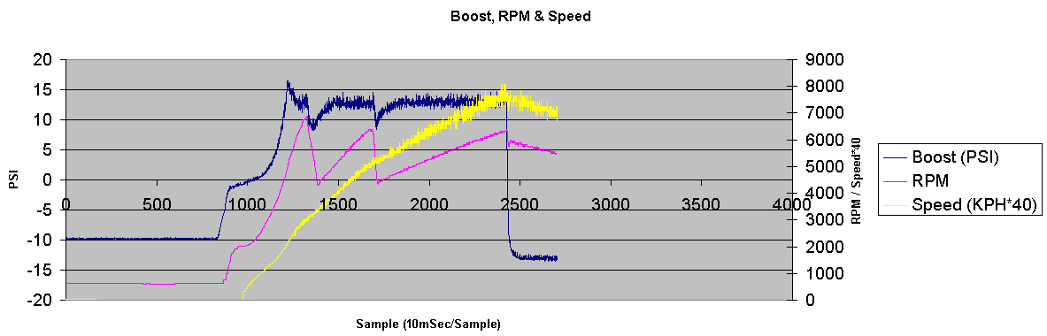

When I get a chance I'll put up a graph that shows gear shift timing currently.

Check epic time between 1st to 2nd shift...
about half a second?
