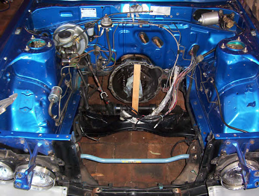

    Hi all, this is a topic I know absolutely nothing about so hoping someone can shed some light for me.
    I have been led to believe that by putting some plate/shield/tray thing under the engine bay that extends to close to the end of the bay that it will create some kind of pressure system and hot air will be sucked out of the engine bay.
    Is this the case?
    Here is a shot of my engine bay.. So in what area would I need to place said plate/tray/shield thing?
    Thanks

    Yup, just look at any factory bay. I'm assuming you don't want to touch the bonnet? and fair enough Could be worth considering a louvered bonnet for track days though as that will also help.
    The raised rear bonnet does NOT work as we all know the base of the windscreen is a HIGH pressure zone
    An understray based on the stock one but a bit larger and a bit more elegant would be the go

    You need to find negative air pressure to pull the hot air out. You also want to exit the hot air from the sides or top, not the bottom. Air under the car will slow it down when trying to attain top speed.
