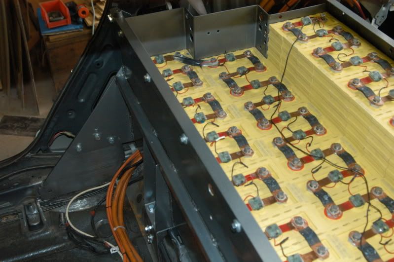

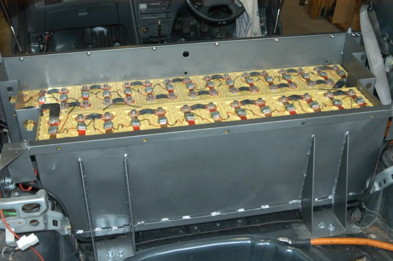

    Finished off all the new brackets and backing plates on Saturday, re-installed the box and batteries on Sunday.
    Currently modifying & re-installing the upper brackets and battery monitoring electronics.
    Should be back on the road in no time!
    I just hope the engineer is not too picky about my spot welding technique for the under-body work, (welding to 0.6mm nicely with my MIG is near on impossible).
    Sealed up vents, prior to painting:
    Rear of box with upgraded lower brackets:
    Front super-impact-resistant-restraint-system (tm )
