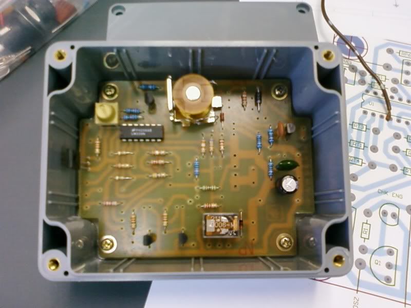

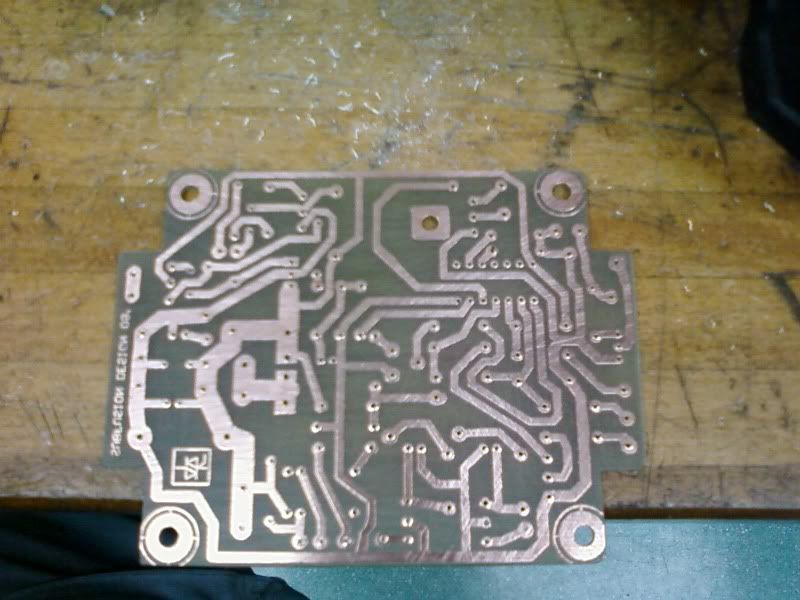

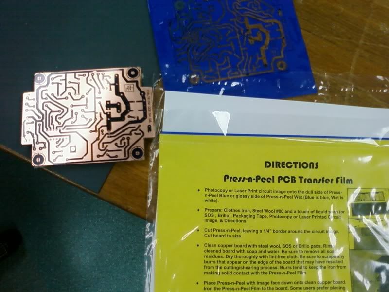

    Designed, proto-typed & tested interface board... more interesting... see blurry photos below…
    Freshly transferred artwork
    Etched & cleaned up

    Currently re-wiring the HV distribution board in the battery box and integrating some other components to make the external connections much neater / safer.

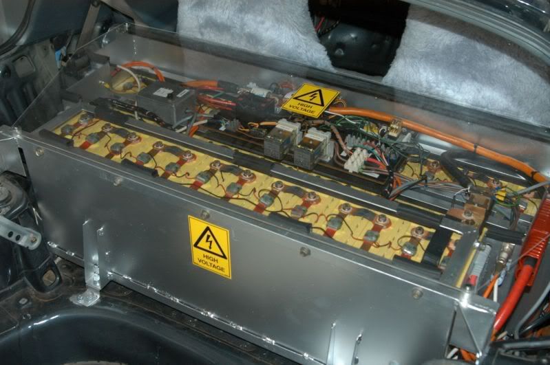

    Default Re: No pistons, no fuel, no worries! Toyota Sera EV Conversion is done... mostly
    Update
    Wednesday, 17 February 2010
    Been hard at work over the last few days, finishing off the following:

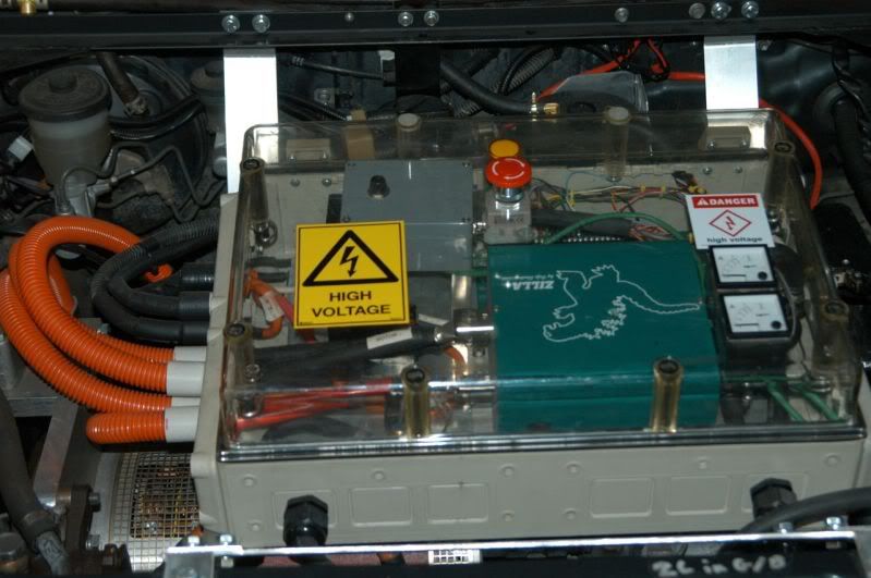

    Battery box wiring, documentation & copious amounts of mods.
    Installed a standby charger for the small SLA battery to keep it topped up when left on-charger for long periods of time.
    Installed a pin sensor for the fuel flap, so when it is open, the relays are re-configured to charge mode & you are un-able to accidently drive off with the plug attached.
    Tested and calibrated dash gauges
    Installed battery box lid
    Attached a bunch of high voltage warning stickers
    Took if for a test drive this morning down to the local weigh bridge, details as follows:
    Total weight: 1125kg (less a few interior panels and carpets).
    Front: 563kg Rear: 536kg Spatial Anomalies: 26kg ;p
    Pre conversion weight (Measured at same weigh bridge):
    917kg (1/2 tank of fuel, full interior trim)
    Went to do a few runs for the 0-60-100 times, but had to let off the accelerator when the battery AMPS shot up to 600 just after take-off (3rd gear), the pack fuse is only rated to 500A
    Have now wound back the max battery amps limit on the ZILLA & will hopefully be doing a decent long test drive in the coming days.
    Rear glass lift-back on:
    Completed battery Box with Perspex cover:
    Completed Zillabox with warning stickers
    Unleaded fuel only, I don’t think so!

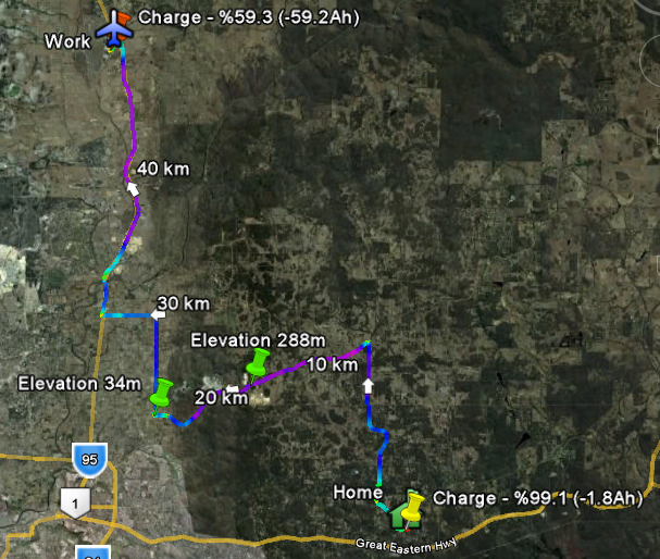

    Hi All,

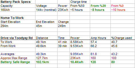

    Not much to report in the way of updates lately, I have been busy lately testing & logging several trips to work & back in order to workout the all important maximum range.
    I have a few mixed results due to issues with my battery meter not reaching %100 charge, so the numbers have had to be re-calculated to take into account the error.
    Here are a few useful bits of info:
    Orig Weight (1/2 tank fuel, no people)
    917Kg
    Modified Specs
    Total weight: 1125Kg, (less some interior bits)
    meas comp old diff
    Front: 563kg 576 551 +25kg
    Rear: 536Kg 549 366 +183kg
    error: 26kg (compensate +13kg each end)
    Weight Distribution
    Old car ~60:40
    Mod car ~50:50
    Range info:
    My Test Trip
    Still need to perform some 0 to 60 to 100km/h tests.
    I rekon it will be close, if not quicker then the old 5E
    -A
  15. #390
    3,275
    Have you had any reactions from others?
    Worked out a deal to charge it up at work? Ultra long extension cord, Beverly Hillbillies style (let's see who's old enough for this).
    Your run looks like more open road style. Is this correct?
    Because your distance to work is similar to mine (but your travel time is half), but I've got a lot of traffic lights to contend with. The stationary bit isn't the problem, but the accelerating away from them.
