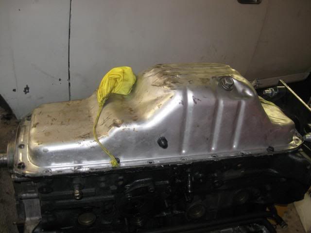

    so what sump do you want me to measure. The mid rear or mid sump???

    ma70 should be rear sump.

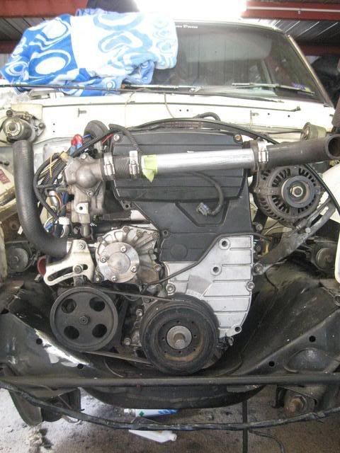

    pics
    Engine front on
    MA70 sump
    155mm deep
    anything more let me know

    I take it that its the "rear sump"?
    Might stick with whats on there and see how we go. looks like i might have to do some fancy tin work
    Member Of The Leaf Sprung Axle Trampers Club
    Act
    2,735
    Default Re: 7M-GE Specs
    yeah thats the mid rear, and the crowns have a shallower and more central sump
