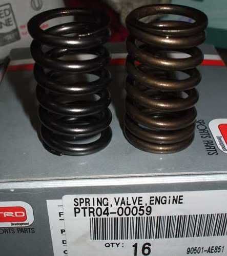

    lift over 8.1 you should also get springs... TRD... HKS... Toda... all are about $160 per set
    I KNOW my set of TRD springs are good to over 10mm of lift (I'm using 8.38) I don't know how much lift the HKS, or Toda springs tolerate
    Here is the TRD spring... next to a stock spring
    Oh... the US part number is the one you plainly see... the part number for everyone else is in the lower right

    You know that the AE851 springs bind at roughly the same point as the stock springs.... give or take 0.1mm.
    NOT..... wish you would have facts to check.... ALL these springs were checked and bind BEGINS at .425" lift (OVER 10 mm) Please... *IF* you are going to offer your opinion...KNOW what you are talking about first

    Quote Originally Posted by oldeskewltoy
    Blah blah blah, unless you have some "uber special" AE851 springs then they bind within 0.1mm of the stock ones.
    I have a set on the shelf in the garage, completely useless, because im running .480" and i HAVE measured them.
    Please feel free to revise your information.
