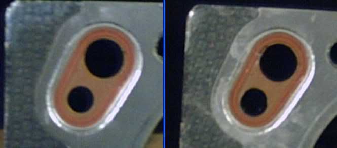

    matter of opinion...
    but the OEM gasket is the BEST gasket (for long term oil and coolant sealing ) bar NONE...including HKS... reason... the OEM gasket has gone through MANY updates and changes which the aftermarket gaskets HAVEN'T done. One particular area to be careful of.... the D/S rear bolt... it is where one of the oil drains is... the newest factory headgasket seals the drain from the rear bolt... allowing easier removal, and properly sealing the drain. Most, if not all the aftermarket gaskets do NOT seal this drain from the bolt! Other areas of importance that the other guys don't do... all the major passages from block to head have a compressable rubber inlay in the OEM gasket...
    Note the orange seal around the entire oil feed.... this seal is NOT found in the aftermarket gaskets.... that orange seal is used at other curcial sealing areas in the headgasket....
