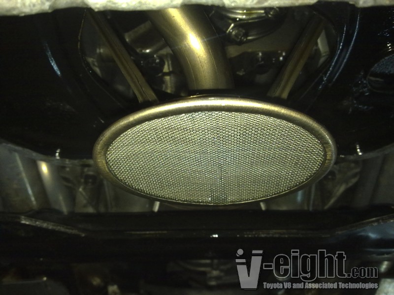

    i dropped the sump again today and noted a couple of possible issues..
    firstly - the oil pickup 'mouth' is about 105mm in dia... its HUGE. now i checked the clearances, and even though its only 5-6mm off the floor, it does stretch from one side of the central bowl area, to the other. (*note - this is a different pickup style to the one in the last engine, though still just athe oem pickup)
    its conceivable that when the oil does move quickly around in the central bowl, that one edge of this pickup can 'just' become uncovered. its not helped by the possible second issue outlined below either...
    ... the second issue being that with oil (not water) in the pan, the trapdoors seal flush so well, that a degree of surface tension 'suction' needs to be overcome for the doors to release from their closed position against the divider wall to swing open. with the 50w oil in there, the doors do actually 'suck down' onto the bowl wall quite tightly and it takes a little bit of momentum/forrce to open them. sure, they do open ok, and they move very very freely, but not without a bit of delay in response to the oil motion...
    so those two things combined, its possible that as oil moves quickly around the central bowl, theres a delay in fresh oil moving in from the wings through the trap doors, and a small dry spot can 'just' devellop under the very peripheral lip of the oil pickup

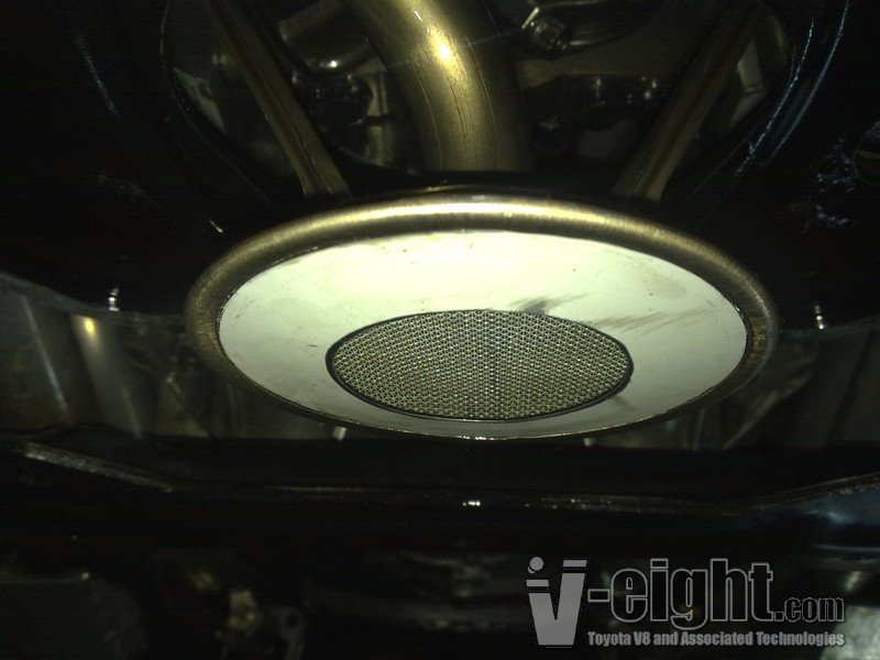

    im also going to try closing down the face of the pickup, such that it can only draw oil up from a smaller central zone about 60mm wide (though nearly the whole original mesh area will still be available for straining the oil). this 20mm will make the likelyhood of uncovering the edge of the pickup zone far less likely.

    wel,, first impressions are we mighthave fixed the surge...
    we made a 100mm dia steel disc, cut a 57mm hole in it, coned it slightly in the press, and voila!
