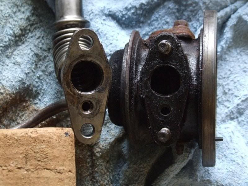

    the picture below is of the oil pipe (left) and where it connects to the turbo (right).
    http://i242.photobucket.com/albums/f...rbooilpipe.jpg
    the oil pours out of the middle of these when all bolted up

    May I assume the turbo you are actually playing with on the car has been properly cleaned unlike the one in the pic?
    If both surfaces (turbo and oil/water input fitting) are both totally clean and the gasket is fresh and new, then I would think A) the input fitting may be warped/bent or B) the turbo may have a blockage in the oil input (turbo side) forcing the oil out between the turbo and fitting.

    fwiw: i ended up re-using a metal shim gasket and sprayed some hylomar on it before assembly of oil lines to my turbo. A paper gasket there might be squirming when you tighten it significantly.
    From memory, those bolts on a CT26 turbo do not have a high torque rating for assembly.
    I'd also check that: oil inlet is not blocked (put hose on it and try to blow), either face is not warped, clean both faces with metho before re-assembly, bolt/stud thread doesn't end prematurely so nut is pulling down flange securely.

    When I couldn't get the right gasket i made a copper one and used the copper base silicone
