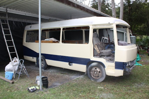

  10. #40
    1,917
    Default Re: 1UZ into Toyota Coaster
    Painted it!
    Before and after shots

  11. #41
    Convictania
    3,093
    nice one!
