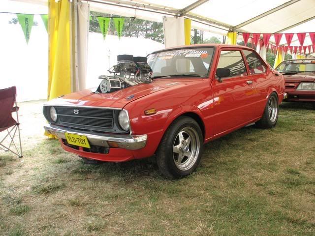

    i wonder what it would cost to buy one of those old engineered and legally registered V8 rollas?
    30K? 40K? having the paperwork increases its value by juust a little
    is YLDTOY still registered or just burnout car now?
    (there may be the option of rebodying something like a hilux with a KE55 body tho)

    i'm pretty damn sure that YLDTOY aint registered as alot of the firewall is missing and it regularly catches on fire during it's burnout demos. which is also all it does now as far as i know
    Default Re: V8 -> Ke55
    looks a bit sad after powercruise...
    Tony DeOliveria (YLDTOY) may not have won the powerskid however you have to give him a big thumbs up for trying. Tony covered well over 400m in his powerskid before losing control of his blown bigblock corolla and side swiping a water barrier at over 200k’s. Luckily he was unhurt and 20 minutes later was found competing in the Off Street Drags.

    we were following it around summernats a few years ago, standing in the tray of a ute,
    we had to get the guy to pull over and let yldtoy go as the metho fumes were making us all cry
