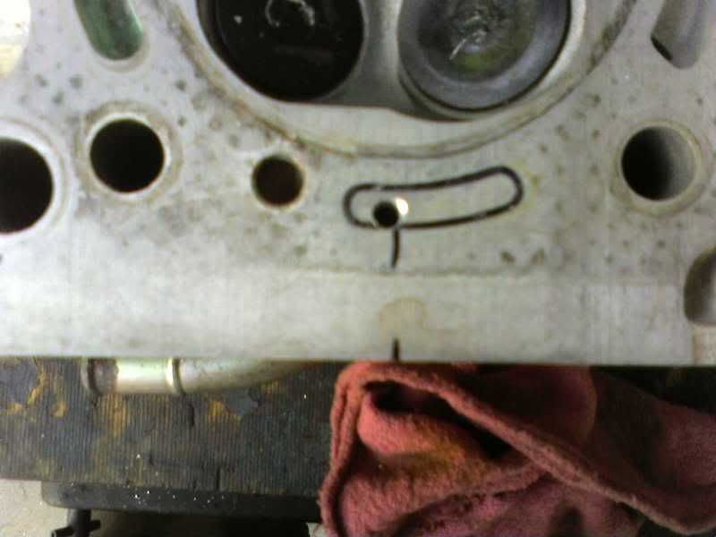

    Yep thats it , I originally did it because id see corosion at that spot that wasnt drilled , the air formed a little pocket that had knowhere to go.
    7M,s have terible water flow and must be improved for better cooling .
    All the earlyer M engines had much better water pumps on them and flowed so much more water than a 7M one .
    A way i improve a 7M pump is machine the step off, around the outer of the pump bringing the impeller closer to the housing.
    They really need a 8 vane impeller like a 5M.

    head was retorqued after 500kms with no boost, and again 500kms with minimal boost
    fretting....
    I think it should be a regular maintenance item, especially if these 500kms increments were during a break-in that was babied & never once got even close to stinking hot.
    The after-market gasket might be an exact copy of the original factory gasket but the factory may have 1 or more newer/improved(?) versions to replace it, with strengthening or progressive coolant passages, materials, whatever.
    The water-pump would help at idle, but I'd go for opening up the passages towards the rear, or even just keeping a high idle for faster flow to equalize things after hard use. Short term hard use probably won't heat up that intake side like a 4000-rpm for an hour on the highway run will.
