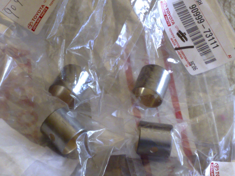

    I have some 20mm small end bushes my engine builder did not use that I need to get rid of.
    Could you measure up the outside for me? And let me know the price
