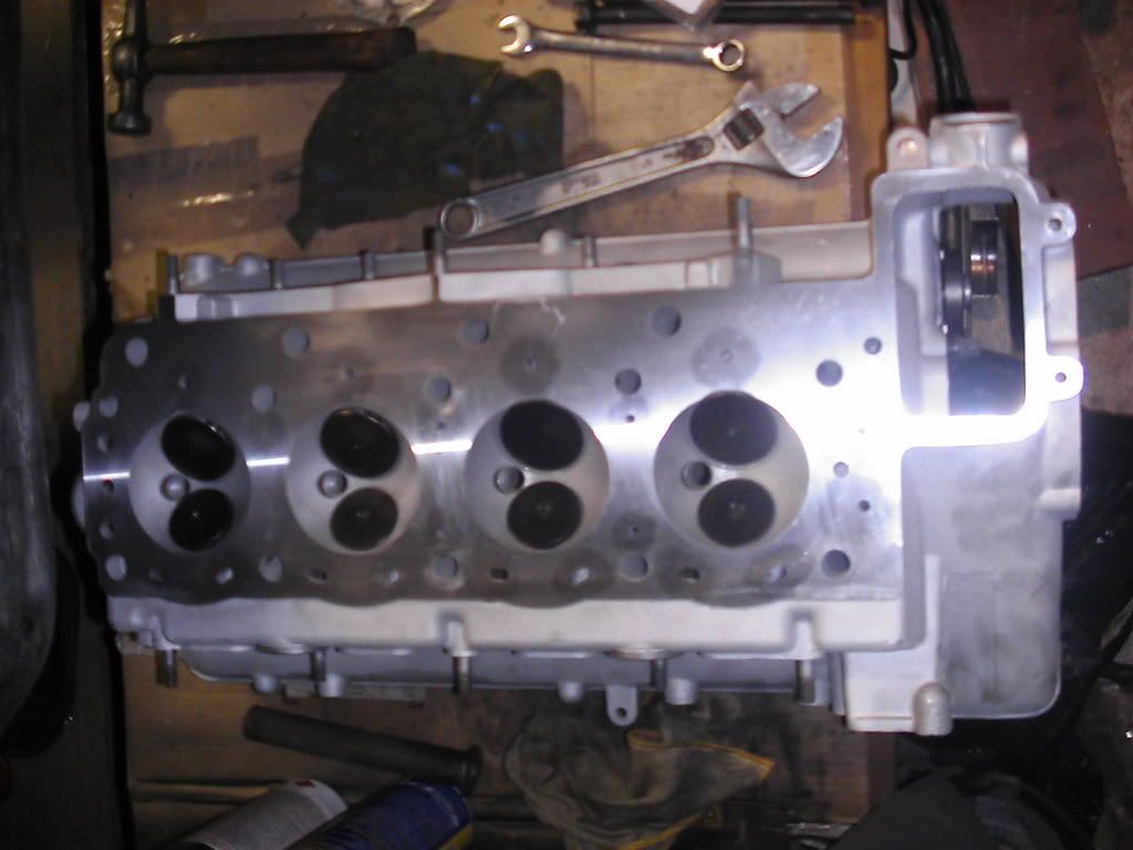

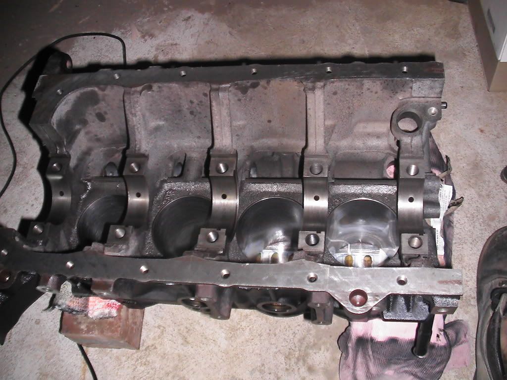

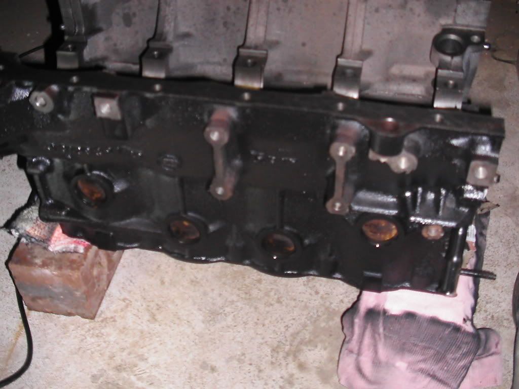

    Ok, so I know its been a VERY long time since I updated this thread, however I was financially uh. . . unmotivated for a very long time . But good news I scrounged up some dosh and began working on my project engine again . i started with taking the old 2TG apart. . . As it the block wasn't needed I got rid of it. The head on the other hand I took down to the machine shop to go through a very standerd recondition. ). so the block was next. A horrid ugly 13T, painted white!?! Why would you paint an engine block white I will never know. So I took it also down to the machine shop and got it cleaned bored one oversize, honed and faced. I was thinking of different colours to paint it. Seeing as though I have decided on a burnt orange and black pant job I figured; why not follow suit? So I painted the block a nice gloss black. .
