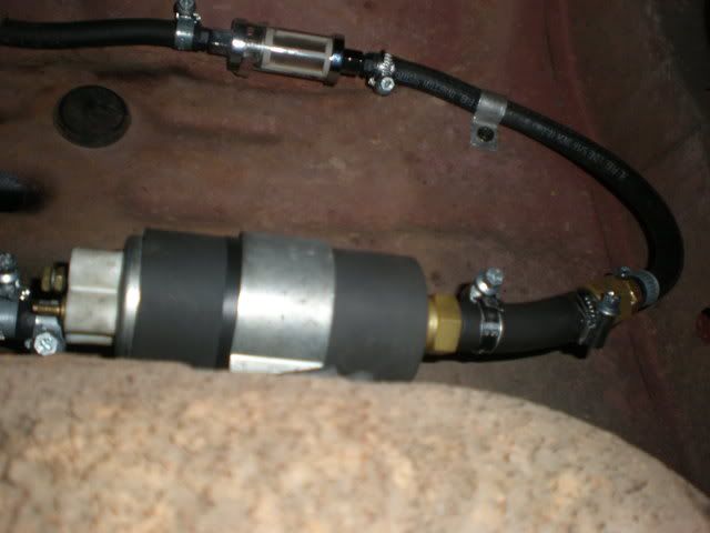

    Alright guys, brief update -
    i replaced the pump today with a brand new GOSS number. hooked it all up, still making bulk noise, almost the same i would say as the old one. only difference is this pump puts out a constant noise instead of the a pulsing sound like the old one. So now it leaves me wondering what would make the pump so bloody loud.
    I messed with the angle a whole bunch (ie holding it in my hand and moving around on all angles and noise remained).
    I bypassed my lift pump and ran a hose straight from my fuel line through a glass filter and then into the highpressure pump. still, noise remained.
    bellow is a pic from my previous set up, but i am still using that adapter (on the inlet to the fuel pump) to increase the size of the hose. could this be an issue....
    i also thought it may have been the pressure regulator on the fuel rail, ie once it opened the first time it didnt close again so the pump was working full ball all the time...i swapped the reg with one off my spare motor and there was no change. so i could assume this was not an issue.....
    any other ideas.....cheers guys.

    ****** Backyard Mechanic 79GT's Avatar
    240
    Default Re: 4TGTE running issue - for the 3TGTE experts :)
    cheers for that turbotoy,
    but first to clarify, in the 22's the fuel tank is in the boot and the picture bellow is under the car, so in this case the pump is well bellow the fuel tank, and the only distance between the tank oputlet and the pump, is enough for a filter and tehn the pump, about 25cm of hose.
    has anyone used an internal fuel pump with a 22. it must have been done before....but i guess with that you would need baffles and what not.....so prob not worth it with the 22's.
    how did the internal fuel pump mod go with yours turbotoy, what car was it in.
    cheers, Jamie
