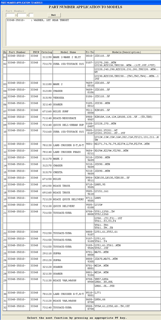

    Toyota EPC says 33348-35010 for JZZ30 R154 for example...
    A cross reference gets a lot...and they are all the same...
    'Martin Crawler' are meant to make an upgraded 1st gear thrust washer?

    Not sure, all I can say is that I see 8701-8801 MA70 and MZ20 on the list, and that's the earliest things that I can think of that came with R154?

    But wouldnt the EPC be updated if new parts were assigned to older cars? looking at the list there you've obviously got a fairly recent version...
    3,468
    Default Re: R154 Thrust washer upgrade?
    What they do in every other case I've seen is simply make a new part number, and then put "SUBS" with the new part number when you look up the old part number
