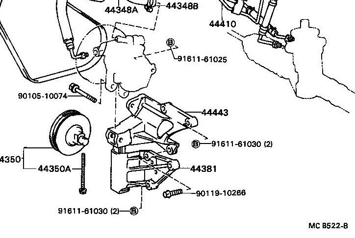

    I've had a dig around the EPC to see which bracket might be the one you are after, and I've had two AE82 with ps but not aircon so I know such a setup does exist
    You need
    44381-12030 BRACKET, POWER STEERING IDLE PULLEY which when xrefd was used on everything from AE82 to AE101, I just think that no one buys a car in japan without ticking the AC box
    44350- 12060 PULLEY ASSY, POWER STEERING IDLE
    some bolts, a shorter belt
    I've found the part numbers below on some bbs in Japan, but from the translation (google rocks!) it seems they haven't yet tried it first hand.
    I'm not 100% sure that the part numbers are correct, so order parts at your own peril!

    Here's a picture of the problem
