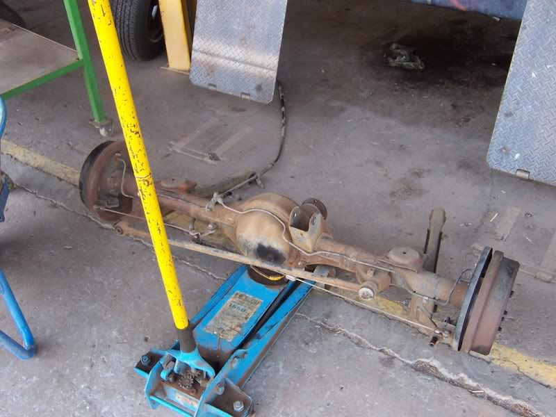

No the Crown MS 112's have a normal differential with disc brakes so I was thinking maybe the Cressidas have the same type since they are related. I need a MS112 type differential for my 75 Crown and I don't want to buy the entire car to get one.
This type of differential is required -

Cressidas aren't really related to Crowns except that they used the same engines in some models. As mentioned above MX73 and later is IRS, MX62 is live axle but E series (I think?) with 4-stud axles and I doubt it would have the same mounting points.

Like Norbie said, you'd want MX32 and 62. After that IRS. They're also 4 stud, drum braked and E series diff.

for memory the MX62 series have 2 upper mounting points, the crown diffs as pictured above only have 1.
MX32 will be the same.- no go.
