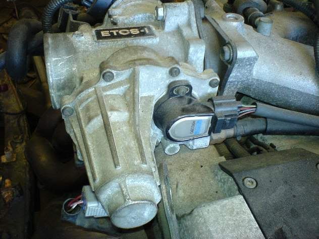

    Just looking at the image Madmont posted, is the wiring for he TB on the near side (4 wires) or on the far side (6 wires?)? ie just how big is the motor?

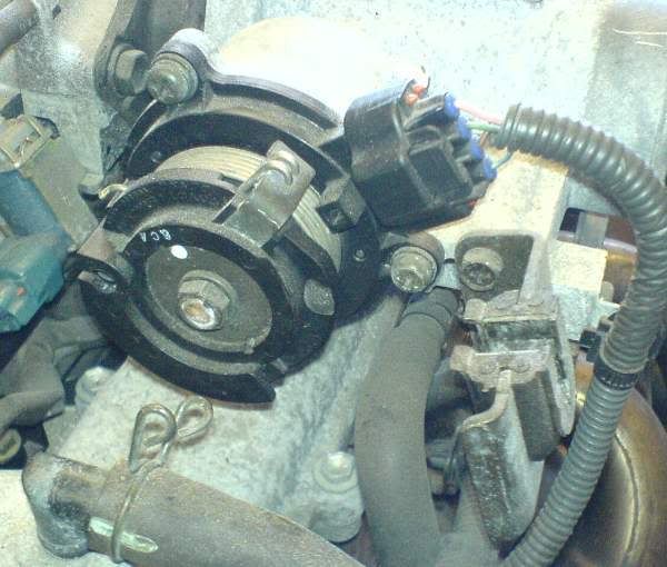

    Here are a couple more pictures

    Some 2JZGTE VVTi ones...
    Stolen from this thread... http://www.supraforums.com.au/forum/...ad.php?t=45926

    Got reduction gearing :O
    That been the case, would these run as an open or closed loop system? closed would seemingly make sense We have the pedal sensors *2, the tps and the motor, would the ecu compare the pedal position to the tps result?

    must say though, it's a suprisingly bulky unit... wonder if you could cut out the crap and stick with motor -> butterfly....
    Errr?? all it has in it is absolutely all that it needs...? I don't get how you could take *any* crap out and still have it work [reliably]?
