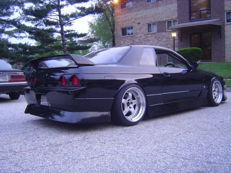

    I bumped into this site while on a search for info to complete this swap, so here are the results of my efforts and the help I received here.
    The car is my drift beaten 1992 R32 gtst. I have halfassedly attemted to do semi pro drifty events with it for a while now but couldnt place any higher than 5th or so because I had always managed to grenade a trans before the final round and RB20s do not fair so well in 4th gear on 2nd and 3rd gear tracks (3rd always blew).

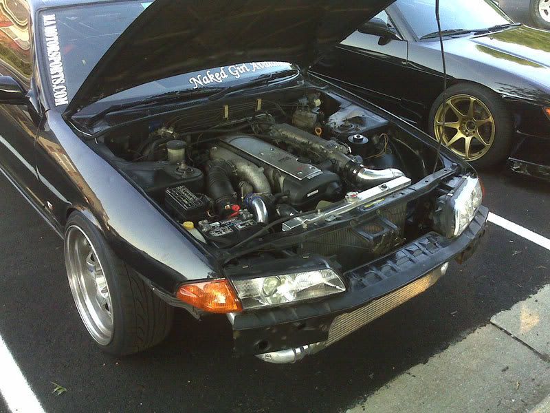

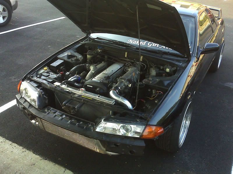

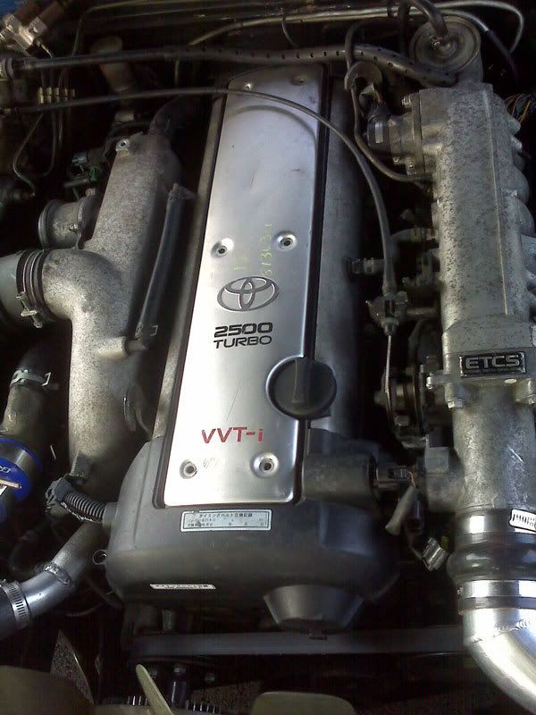

    The engine is a 1j vvti from a jzx100 and the trans is a 89 or so supra trans (r154) with a 1j bell on it. Besides the pipe work we did, the exhaust, and a walbro pump, it is completely standard....even the clutch.
    The car is what it is, a beaten drift car with the usual stuff, cusco coils, all the multilink mess, welded diff, cage, nothing fancy.
    Well, on to the pics and the vid someone took of the entire event. It was a very fun day and the car performed FLAWLESSLY. Very few people in the US drift community pay the 1J any attention, but alot of heads were turned when this stock 1J powered heap did the entire course (usually all 2nd gear) in 3rd! It seems to be the perfect match for the R32 with so much potential yet to be tapped....and OH SO CHEAP to boot!

    Ps. The specs on the engine are Home made intercooler/home made exhaust/walbro fuel pump/ and NOTHING ELSE. Seriously.
    Car weighs in at 3000lbs without me in it but with 1/4 tank of gas.
    Car has nothing special done..
    Coilovers are cusco zero2r.
    All multilink stuff is e-bay junk.
    angle mods are ground down stops and angle spacers.
    Rear end is stock S13 diff welded up.
    Cage is 8 point that we buzzed together.
    Seat is sparco evo
    Harness is some simpson thing that passes tech...hehe.
    Brakes are stock
    Kit is $300 fake uras
    wheel is some beat up sparco thing
    Car was originally an auto and I used LHD S13 pedal and master cyl with a little modding to make it 5spd.
    wheels are 18x9 -7 and 18x10 -0 work meister s1rs.
    Tires vary but fronts are 225-40-18 Falken FK452 and rear is whatever I can afford (usually 245-40-17 or 255-35-18).
    Paint is stock, fenders rolled, kit spray canned.
    Drive shaft is the only thing not done by myself and friends. It was about $200 locally to have it peiced together.
    EDIT again with more info.... Mounts were made from a jig my friend had for S13 1J swap. I swapped the R32 crossmember for an S13 one (bolts up) and then used the S13 1J mounts.....fits so nice and uses S13 motor mounts. For rear cross member, we used the R32 crossmember sides and some angle to mount it up with the R154 rubber mount. Wiring was where yall helped out tons! I found all of the pinouts I used to get the stock ecu to work perfectly right here. The gauges run off the same resistance as R32 ones so everything is accurate. I am working on making the speedometer cable drive work (both are cable driven so not a big task). The only tuff part is getting the exhaust to clear the steer shaft, but it was only a 2hr or so fix... S chassis with 1J should be GREAT FUN... more should do it.

    I paid $1800 for the whole setup... engine/trans/bellhousing/stock clutch/harness/ecu.
    The I/C piping was tigged up out of spare stuff and an SR FMIC kit. The intercooler is a greddy core that we welded some random ebay tanks to.
    The exhaust is Buddy club spec2 for R32 and a downpipe for a regular 1j that we used the flange and rearanged the piping from.
