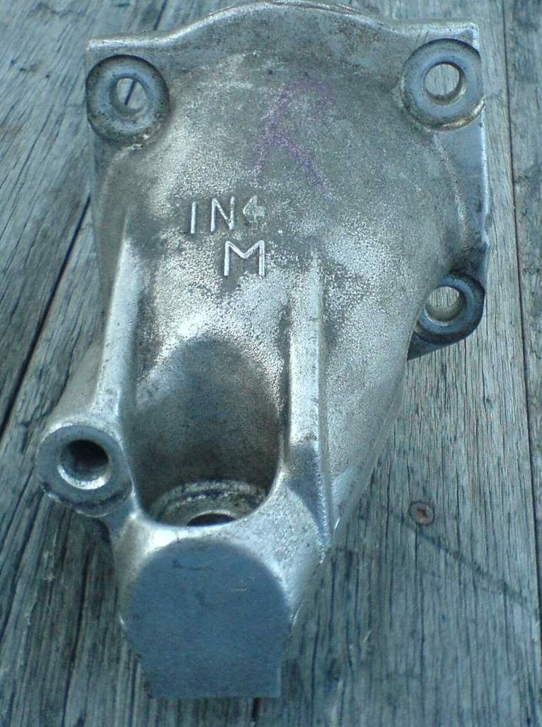

    i found what it is from. A Lexus GS300 2JZ.
    will try and order one tomorrow thru toyota.

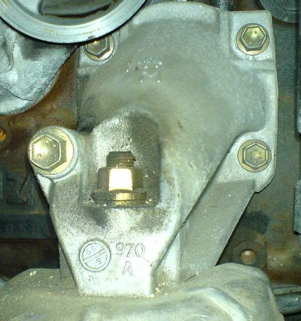

    So if you have a front sump 1JZ or 2JZ and a the early Crossmember in your MX83 cressida you can mount it easily using Two Lexus GS300 2JZ Inlet side alloy mounts on factory 7MGE cressida rubber under mounts. You just need to mill the mount down 10mm where the stud from undermount comes thru.
    will do a write up on this when i have the part numbers tomorrow!
    cheers for all the help guys!

    I have one here looks much the same off a JZS161 2JZ as far as I know
    I can measure to make sure if you like

    I just found one on my 1JZ JZS171 motor looks exactly the same as yours
    Jealousy is a curse

    hey dan if that vmount is off that old 2jzge ,the bloke i got it off said he pulled it out of a jza80. cheers bigwad
    5,543
    Default Re: Engine Mount help please ! urgent lol
    Nope, they 110% arnt JZA80 mounts.

    they are both the ones i need guys! lol
    awesome work ......
    but i got one today new from toyota. maybe there not so useless lol
    PART. NO - 1231546120
    from a Lexus GS300.
    They have plenty in stock in melb and sydney.
    Cost $92.10 + freight over night.
    STOKED!
    thanks for looking though guys....great help
