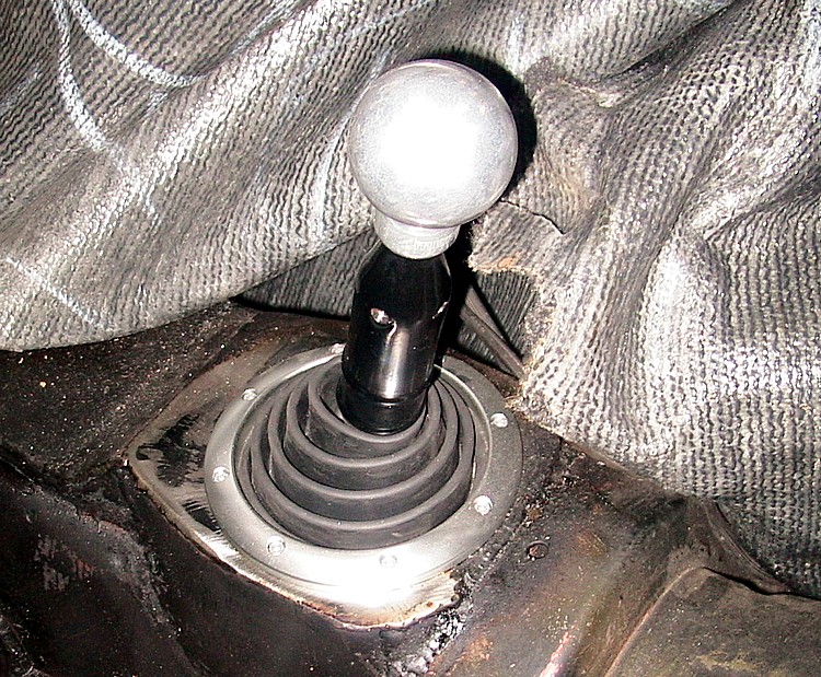

    I stole this off the net for you:
    You may need to love the top of your tunnel a lot more than you happy with. The remote shifter also sits up really high on the back and it sits a long way further back too (It hangs out the back of the box). A J160 into a TA22 is not a swap for the faint hearted - They are a tight fir in a 28 or 23 (have done both). A W58 swap in any Classic Celica is much less involved.
    This image will give you some idea of the shifter issue you will have in a TA22 with a J160. If you happy to do a "little" cutting and resheeting you will be fine. They are a lovely box. But it wont be a quick swap. Oh and the Gearbox mount, its also nothing like the W58 item and brings with it some challenges of its own. All doable of course.
    Oh and the J160 has an electronic speedo, so you need a manual speedo gear assembly out of a W58 too to run your Speedo cable.

    Right! The pics of a J160 I have seen on here ( as above) all have the starter motor and clutch cylinder on the opposite side of the bellhousing to the T50. Our J160's are the opposite hence the need to turn the fork around. I just know it won't clear the exhaust tubes.
    Secondly, the bellhousing on the J160 looks HUGE and yet I'm told that it bolts on to my engine block. I'm sure it does but it looks massive against the T50!! I see what you mean about loving the tunnel out, I had no idea it was that much loving!!
    I can get around the shifter position and gearbox mounting.
