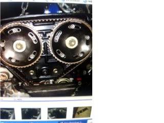

    Jordan: Just use a bit of liquid paper to mark where the gears are now. undo the little adjusting screws and on the cam gear ( i to think they are gears ) turn the cam to 0deg with a spanner on the cam bolt and tighten them up.
    Once you pass then you can undo the cams and set them back to the white marks and your done mate!
    Default Re: procedure for re-adjusting cam gears???
    and as supplement.. take a pic and post it here, so you won't forget which way they were mean tto go
    can you check with the dyno guys as to what angles they are at now?

    Now as for adjusting these, as mentioned previously. Mark where they are currently set, loosen the 5 bolts towards the outer edge of the cam gear. Rotate the inner part/camshaft with a spanner socket on the bolt in the middle, then tighten bolts back up.
    Do one cam at a time.
    Also, by setting them at 0 might not help for engine vacuum. You might have to have a fiddle with them to try and find the best spot for them where they create the most vacuum at idle. I know the cams I have which have 235deg@50, don't have a huge amount of vacuum at idle (like about 4" of vac when set at 0), but I can set them so the gauge will read around 14" of vac.

    well when your sitting in the car with one foot on the brake and the other on the acc, when you rev the car between 1000rpm and 1500rpm you can feel the brake pedal go up and down while watching the boost guage do the same thing. dont think there is anything wrong with the booster because before i changed to a ma70 booster the stock and supra booster did the same thing. included is a pic of the cam gears as they sit, sorry about the quality but you get the idea. hope this helps
