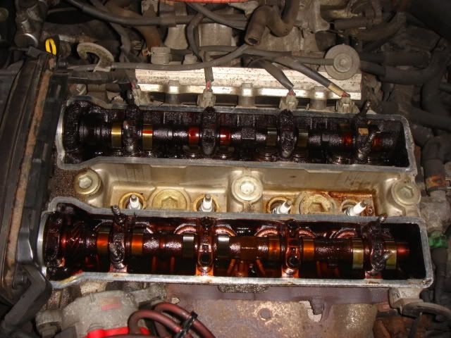

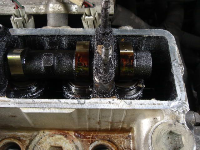

    My 4AGE has recently been sounding like a bag of bolts so i thought it may need re shimming. Took the cam covers off and checked all the valve clearances and they were within the tolerances.

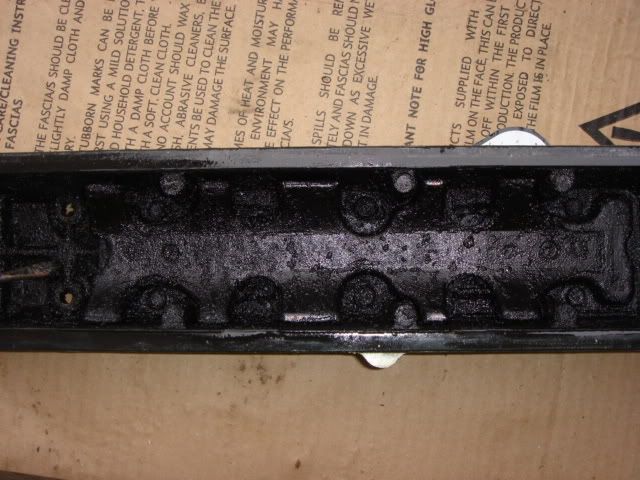

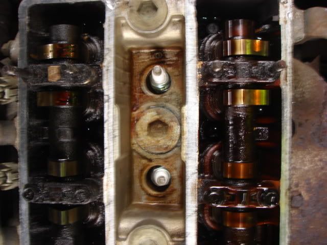

    One thing i did notice was on the intake side there was a lot of build up of grease and dirt. I am thinking this may be the source of the problem. I have posted up some pictures of what i found and was really after some advice as to whether this was the cause of the problem and how to go about rectifying it.
    What do you think?

    engine's had a poor service history.
    It's not hard to clean out the cam cover, but you'll have a very hard time cleaning out the atual head.
    Have seen a couple of import 4ag's that look exactly like your photo's. I got lucky with the last one I purchased and it was still silver under the covers

    If i clean out the head will it solve the problem of the noisy engine? Could do with some tips on how to clean the head without taking the head off... any ideas?
    The cam covers will clean up easily enough, they wont be a problem. My major concern is the noisy engine. So looks like the engine has not been serviced regularly. Does it mean nothing to worry about once all cleaned up?

    No, but you do have the potential to make it worse if that's possible at this point, with my assumption that the noise is a rod bearing.

    Id say a head rebuild is your first step.
    Take everything out and get it dipped in (something). Im not going to suggest what because im not sure if the acid will burn the alloy.

    Youll be able to get the head clean yourself using brushes, petrol, degreaser, and warm soapy water. Its not a quick process though and definately not something id be doing with the head on.
    As has been said above it seems like the car has had a poor service history and it wouldnt be suprising if as a result it has some worn bearings.
    Alot of the oil in the covers and head will be burnt on there also. Most probably from the engine having been given a fairly hard life.
