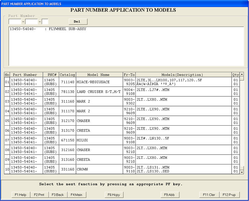

    2L-TE flywheel
    13450-54040
    You drive the EPC like your drive your car... I kids!
