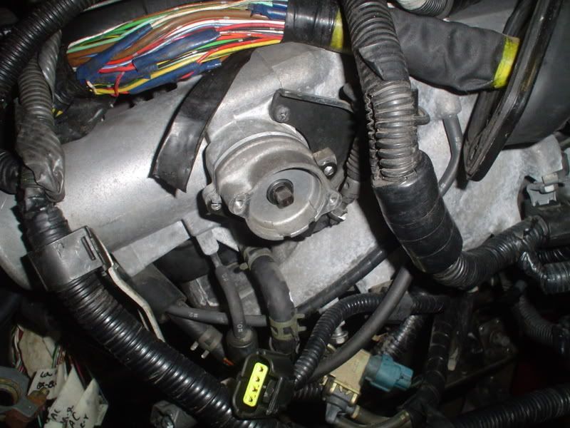

    i have a trc 1jz throttle body from a jzx81.
    I think i maybe missing my tps sensor, but i'm not certain.
    the pic below is one i found on the net which i edited.
    where it is indicated "A" in the photo is where i have a sensor which connects to a throttle plate inside the throttle body.
    however on spot "B" in the photo i have a sensor missing, and from what i've been getting at in seeing photos of peoples non trc tb, that is usually where the tps sensor goes.
    all i have is this in the typical tps spot
    i bought a tps sensor (pt #89452-12080) from a 2jzgte which someone had sold me, but it didnt fit in the tps spot at all
    can anyone confirm this?

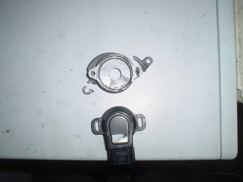

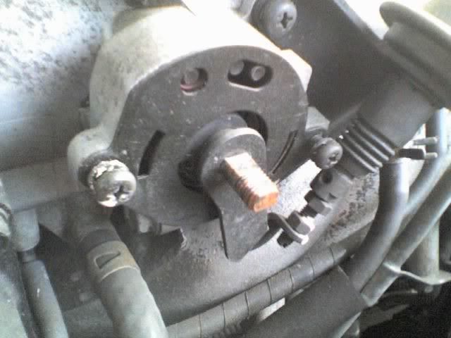

    You are missing the TPS bracket...
    Hope the below pics help...

    Default Re: 1jz tps sensor question
    thanks, that answers my question perfectly.
    now i just need to locate one.
