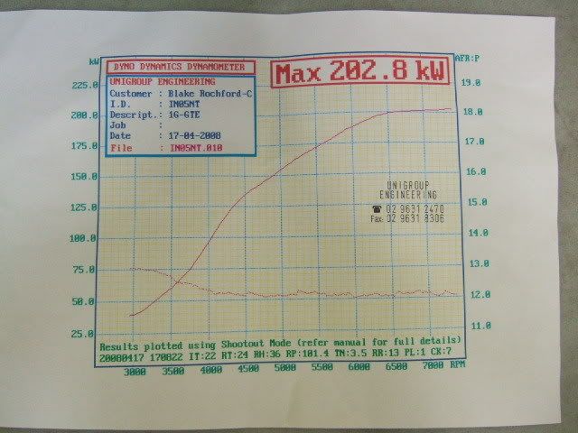

    What Model engine? Got a dyno graph ?

    1G-GTE (10fknchar)

    gotta love unigroup! how nice does that graph look!

    your missing out on a shitload of midrange by the looks of that graph.
    it should have about 180rwkw at 5200rpm with a more open rear housing and the cam gears set correctly.

    i'll work on the rear housing soon, save a bit a $$$ and get full house tune going, as i gave them a $300 budget to get that tune, whick Yuvoz did a mad job me thinks!
    That's true. Its seriously being choked.
