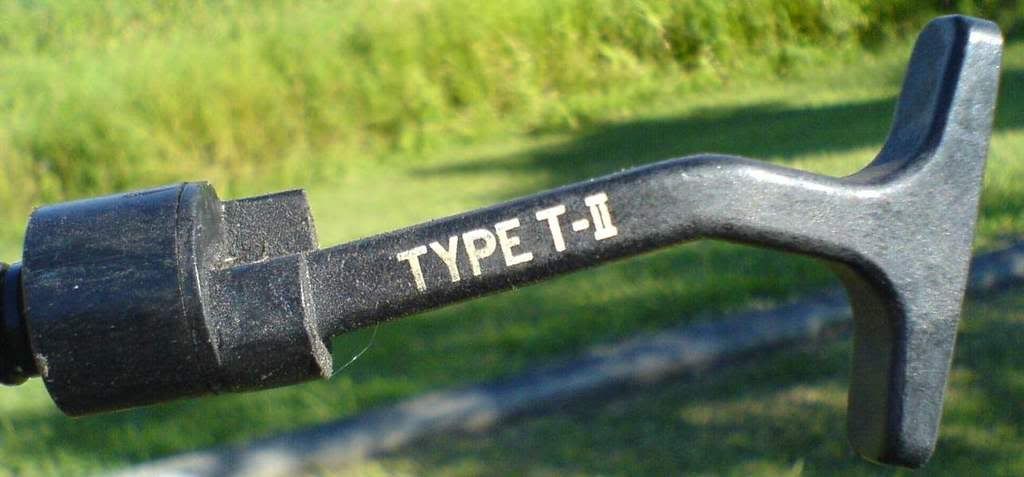

    Default Re: a341le transmission fluid? (from jx81 chaser)
    Check your transmission dipstick, the fluid type is normally embossed onto the wet end.
    i would check my dipstick only that this motorset didnt' come with one.
    my 95 a340e out of my lexus sc300 used dexron. but i hear mixed opinions on what fluid everone is supposed to use, i thought i'd ask since this the jzx81 transmission is fairly old, 90-92 year model.
    i think im going to go with dexron as type ii fluid probably came out much later. also my sc300 acted just great with dexron.
    ok so as i took the drain nut off of the transmission pan I noticed the nut itself is marked "D II"
    so yeah this definitely confirms dexron ii.
    Mine has TII on the plug and dipstick
