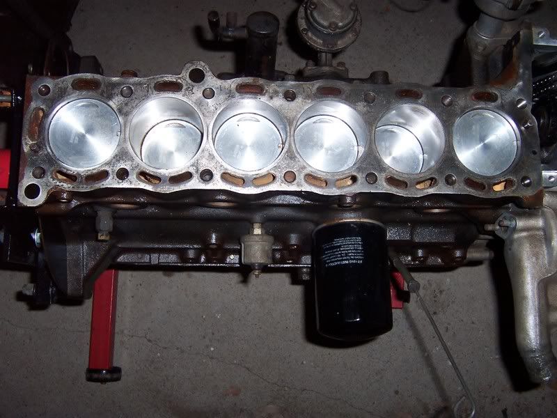

    I still have the pistons in there holes and still connected to the crankshaft, the head gasket is a cooper looking material which still looks ok. I was told because the engine had sat so long the rings will need replacing, I would prefer not to replace them but then again I now have the engine apart so whats the harm, if I was to remove one piston and take the rings to an engine rebuilder could they tell me if they need replacing.

    Head gasket is only good for a sample to get a new one made if you can't find a off the shelf one to buy, never reuse a head gasket it will only lead to problems. Take your sump off and and do what thechuckster said.
    I would be very suprised by looking at those bores if the rings were dead.

    All pulled apart both the front and back covers and sump cover, I pushed out a piston this morning and have been told they are still in perfect condition so when the complete gasket kit arrives on Wednesday I'll refit the new seals and get it ready for a coat of red the put it back together. I refitted the piston and rings with a piston ring installer from work this morning, I'm on 10 days toil leave..

    Theses no corrosion in the bores as I removed all the pistons today to check but some of the bores had some hard engine assembly goo stuck around at the top of the pistions. I used thiners to some steel wool to gently remove all this. I also degreased all the bits in the bottom end around the crankshaft as it had big chunks of hardened oil in there, I unassembled using assembly lube and torqued everything back to the tensions in my Crown repair manual.
