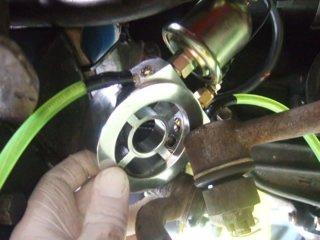

    that adaptor even has a bloody screw in it for the earth wire already!!!!!! (visible in both pics)
    why not just use that already....
    6,193
    Default Re: oil pressure gauge bouncing off its nuts.
    His does, mine didn't.
    Mine needed earthing to the sender though, earthing the sanwich plate wasn't the issue.

    I was wondering what theat screw would be used for - looked quite funny and didnt come on the one i had (didnt actually get to use it as the gauges were stolen).
    ahh gotcha

    i knew that screw was for an earth but didnt think much if it, as ts earthed through the oil filter bolt (obviously not good enough),
    im now putting YLD's theory to the test, got it apart (coz cant get to teh screw with it in place), just gotta fit up the earth straps,

    been thinking about this, your sandwich plate would not be earthed because of the normally rubber o'ring seal and if you used thread tape to seal the sender. Didnt have any problems with mine because its got a fitting tapped into the block for the oil feed and sender.

    no, but the oil filter thread, that the oil sandwich plate bolts to is screwed into the block, so there is an earth in it,
    BUT IT STILL HASNT SOLVED IT!!!, FITTED 2 EARTH STRAPS from the filter plate, one to an engine mount bolt to the block, and the other to the body in a random bolt hole,

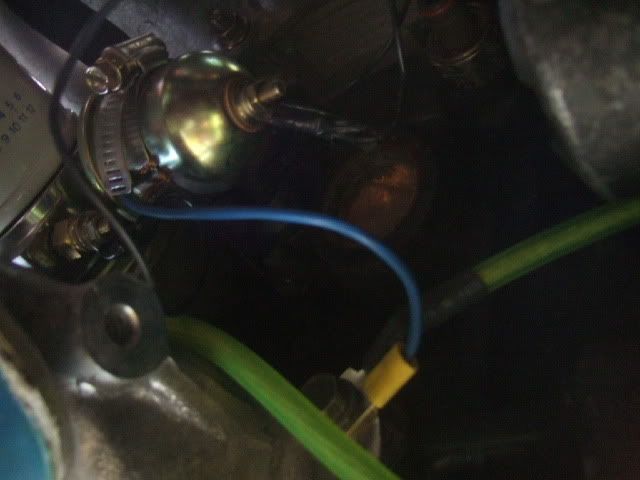

    For testing purpose either do what myself of Norbie did and use a cable tie or a hose clamp to attach a wire to the surface of the can that is the sender unit. The attach the other end to some clean body or engine block.
    Earthing the sandwich plate and not the sender unit itself didn't help in my case either.
    The blue represents a wire with an exposed end attached cleanly to the can of the sender unit and the other end earthed.
    The red represent some form of strap to hold it in place.
    The orange is a frayed wire end pressed against the can body.
    Make sure the can is just a galvanised surface and not clear coated too.

    haha thanks YLD, yeah after re reading it i went back and did excactly what you drew, (only got access to the net when the boss is out of the office 30secs at a time!)
    so i earthed the sender unit with the wire and a hose clamp around the sender,
    STILL NO BETTER!....AAAAAARRRRRRGGGGHHHH edit, i may try moving the earths.

    took forever to load these pics!
    this is waht the mess looks like now,
    STUPID qs, but will the alloy mount earth ok, or should i move the earths?

    for testing i would use a lead with an alligator clip on it and run it back to battery, definate earth that way, just eliminate all variables and see what fixes the problem.
