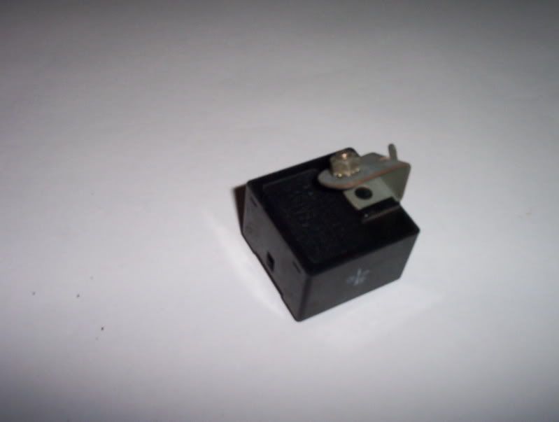

    Ok... i've just got back from the wreckers, & now have 2 x item in question.. but need batterys for pic' machine thingy....
    i'll have pic's in the next day or two..
    as i had to buy these items i'll sell them on once this thread has been up dated..

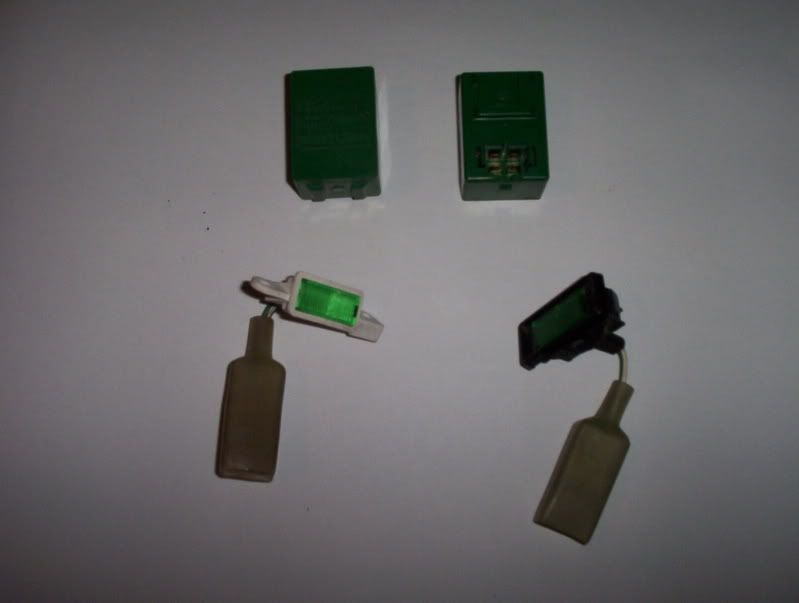

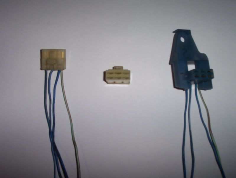

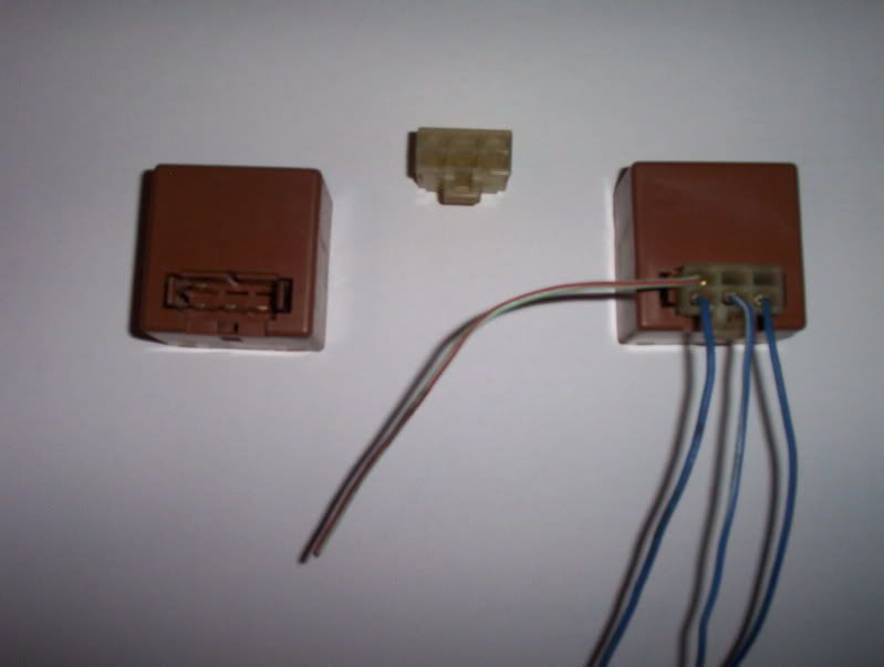

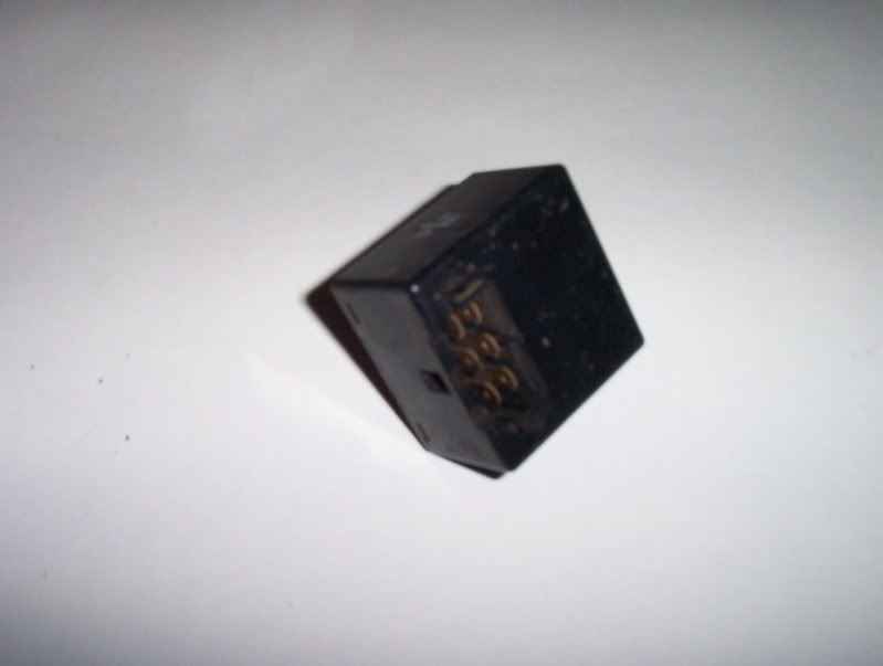

    I have also used the rear int' wiper "BlackBox" for rear int' wiper on an RA40 Hatch, & this may also be the same as the 'BrownBox" i'll open them up & see if they is the same..??

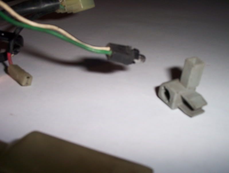

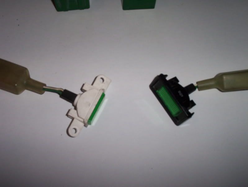

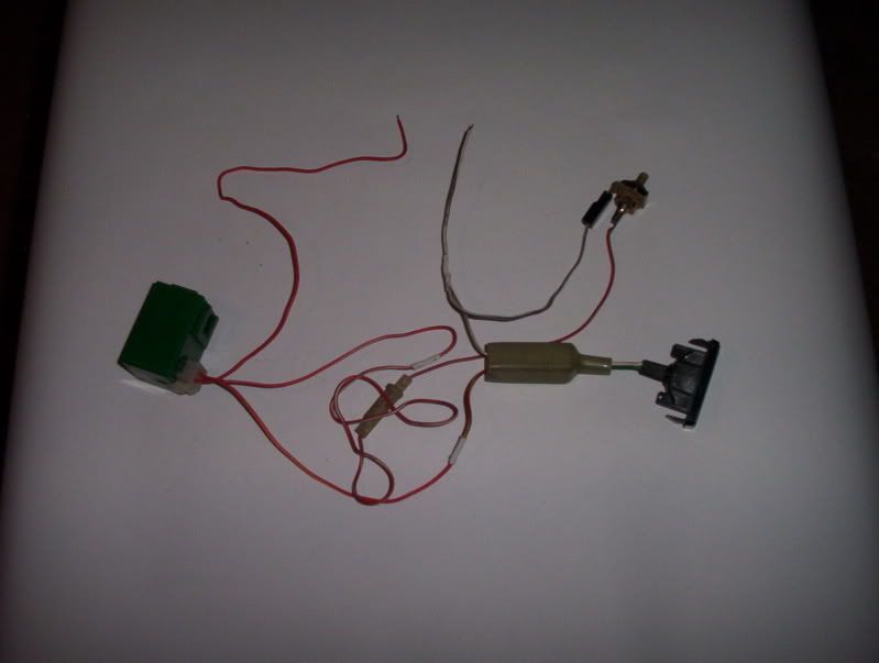

    I've also fitted these "GreenBox" from the RA60/3/5's. they are found in the front R/H kick panel, on the fusebox..
    with the use of this GreenBox & a few extra lamps that you will find in RA60/3/5 & R/ST141/2, this will give you a pair of "Footwell" courtesy Lamps with a 30 second "On" delay after the door is closed, it can also be used for a lamp around the ignition switch, (So you can find the hole)
    I'll do a wire diagram for this....
    you will also find many small lamps in the RA60's etc.. these can be use in the lamp cluster on the dashes in RA23 & RA28's.. I'll explain more latter..
    cheers.

    Just use the "Brown Box" found iin the RA40, RA60, RA63, ST141, etc.. they are easy to fit.... you can even run a seperate switch if you not want to fit the indicater/wiper stalk..
    i have ever used them for int' rear wippers on a RA40 Hatch, with just the extra switch....
