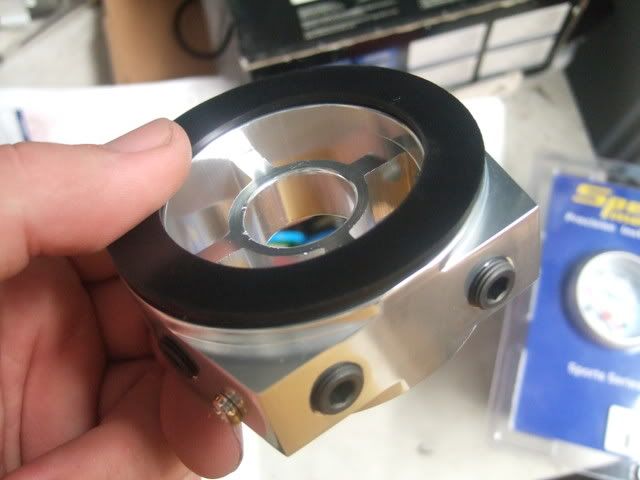

    ive got an electric SPECO oil pressure gauge hooked up to the 1g,
    cold start i have around 80psi, when warm it sits on 40psi,
    BUT when you give it a sharp/hard rev, it bounces all over the place 0- 100psi,
    if i give it a rev, and hold the revs, say 5000rpm, the gauge settle to around 20psi,
    but the bouncing bit when you give it a hard rev, is that normal? or is it the gauge or sender playing up?
    ive got the sended mounted in a oil filter housing sandwich block,

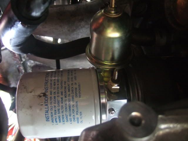

    Although it shouldnt be going to 0 - the only thing i can imagine other than a faulty sensor is a slight break in the oil flow (is it to or from the filter where it is?) or a dodgy ground that gets affected through variable engine speeds and not affecting it when constant. I cant see the pic at work - but if its a single wire then it should ground form the engine and because of the rubber seal on the sender adaptor this may not be occuring.

    The sender needs to be earthed better.
    Mine did the same thing, added a little earth strap to the sender body and it fixed it immediately.
    I will put a dollar on it that it is your problem too as your symptoms are exactly the same

    you could try dodgily by getting jumper cable and clamping around body of sender, to anywhere with earth.
    3,806
    Default Re: oil pressure gauge bouncing off its nuts.
    Yeah I had to attach an earth cable to my sandwich block before my oil pressure/temp gauges would read properly. You'd think being bolted to the block would earth it but apparently not.
    I squished an exposed end of the wire against the sender body using a hose clamp. It works but there are probably neater ways to do it.

    Quote Originally Posted by Norbie
    I did the same but used a stainless zip tie and put a male spade on the end of the wire.
    It's usually pretty easy to hide the wire on one side of the sender out of sight.
    In my case I always use the Locktite master pipe thread sealant on the NPT fittings for peace of mind and I think that would act as an insulator somewhat.
