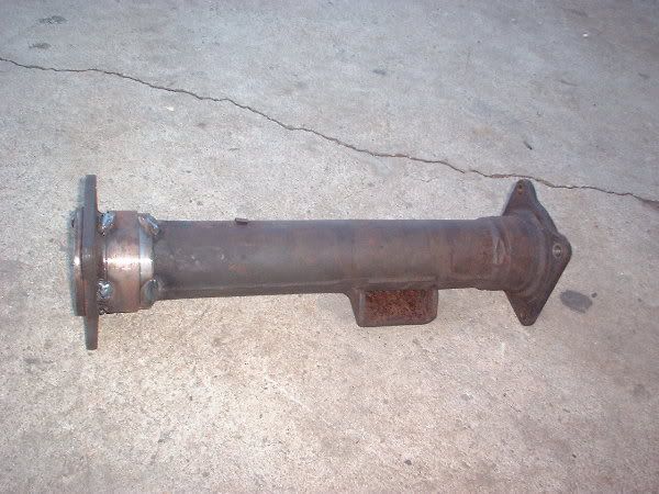

    669
    Default Re: dismantling hilux diff
    Or you could follow the directions in the manual. I made the SST from an old housing.
