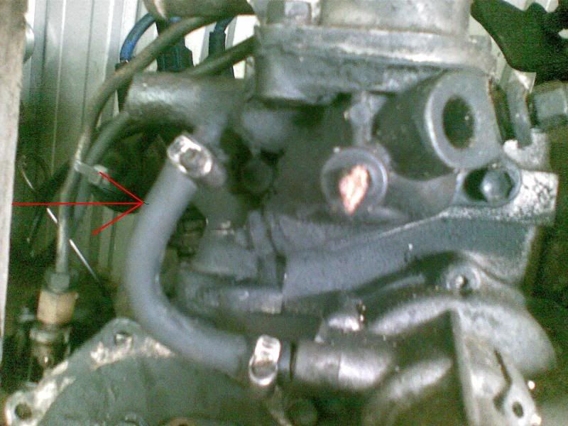

    is it the one in the red circle?
    there is no wire connected to that sensor when i started to dismatle it.
    2,765
    Default Re: KE70 Water Temp guage
    that doesnt look right.
    wrong sensor and wrong spot.
    on the ke70, im pretty sure its hidden underneath the vac hoses shit, on the right hand side of that top hose outlet.
    pretty much under the thermostat.
    it should just be a single wire to it, and a single spade connecter on the sensor.
    ill drag a k motor out from the naughty corner and take a pic if i still have one intact. if you cant find it.
    cheers, andrew

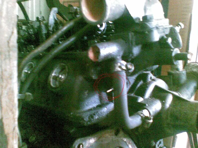

    that looks liek the thermofan sensor.. same spot as the EFI starlets..
    seems you have a thermofan instead of water pump driven fan...
    look on the lower half of the thermostat housing.. pointing out to the side....
    2,765
    that should be the fella
