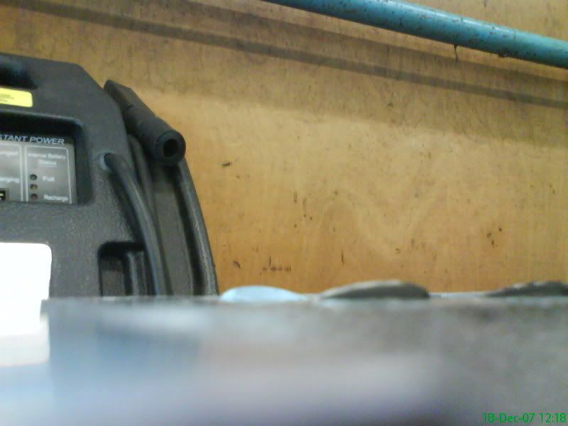

    My motor (which I still haven't started), has a bit more taken off the head than that.
    If you have a look at the lugs under the inlet ports you'll get an idea of how much we took off:
    (The chamber mods are to try to bring the compression down a little and I decided to have a go at this)
    When I bolted it on, I had to trim the metal timing cover in order to make it fit, but the cams lined up perfectly.
