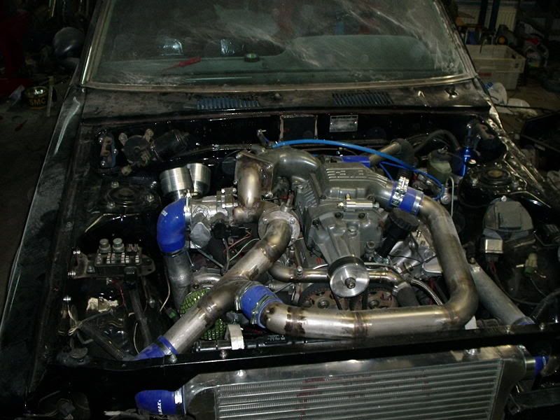

    What is your compression ratio going to be? I recommend quite low. In my setup I have 8:1 and i think it could be lower since the grunt at low revs doesnt seem to be a problem. There's plenty of torque to put wheels spin at any speed or revs. Tires aint the best, I know.
    My setup is
    AirFilter -> Garrett T4 60/65-> Throttle ->Eaton M90 -> Intercooler -> 1G-GZTE
    Setup isnt dynoed yet. So i cant really tell you about torque curves or about power. But both factors seems to be present while giving some Adidas to pedal.
    Turbo starts to boost quite neutrally at 4000rpm or so. When I jammed Eatons bypass open and went for a test drive boost limit went like 2000rpms upper.
    I have driven few hundred km's so far. No problems so far with the twin charger setup. Rev limiter is now at 8000rpm and boost is set to 1.6bar.
    It's freaking winter now. So this off the road now and will go to dyno soon.

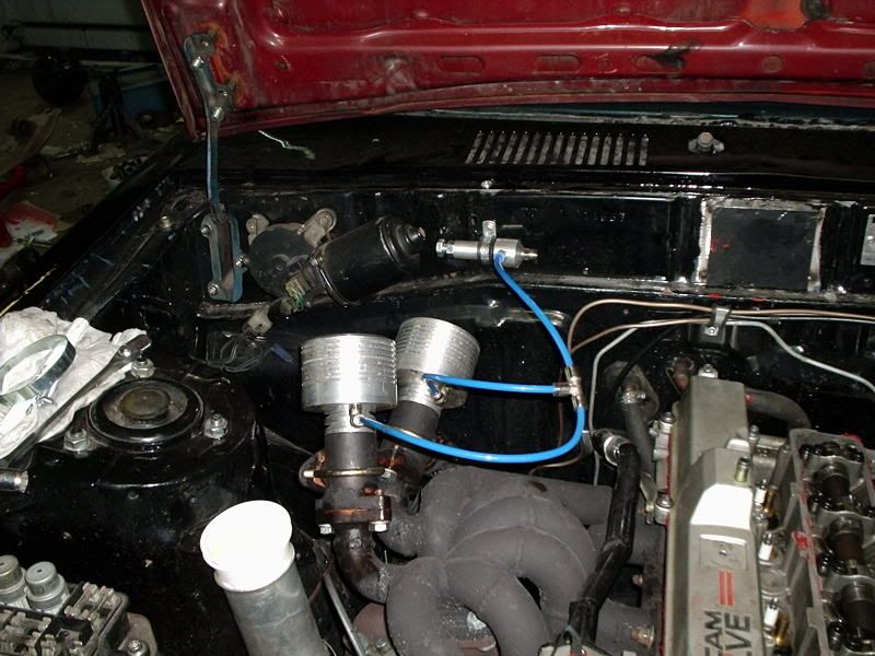

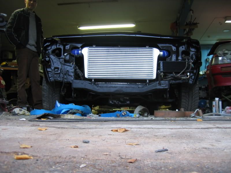

    Few (not the most present) pics:
    kkjhfd
    hgfhh
    fdasds
    fgfdh
    hgfhgh
    dfsdf
    Thats me! lol
    Shoot with the questions if you got some...
