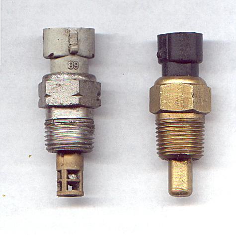

    Get an open cage sensor that has a bakelite covering (as found in V6 commodes and othr bosch installs) rather than a solid brass unit as it will react faster to changes in air temp and be less prone to heat soak.
    (open cage on left)
    mine is in the pipe after the TB.
