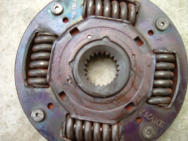

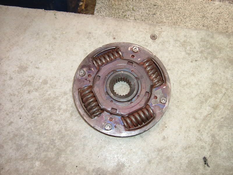

    Default Re: funny vibration 4age 20v ae92 fxgt
    well i think i found the problem
    on saturday the fxgt broke down with no drive going to the wheels.
    Funny noise when the clutch pedal was pushed in.
    Got the gearbox off today, i figure this was causing the vibration.
    Exedy clutch kit about a year old.
    Everything else looks ok, so will probably get flywheel machined and a replacement clutch plate.
    Should i just get a genuine one or get an upgraded after market clutch plate.
    What wouldve caused the clutch to have done this anyways?
    Junior Member Domestic Engineer BigWorm's Avatar
    650
    Default Re: funny vibration 4age 20v ae92 fxgt - holy clutch batman
    Where's the rest of the clutch plate???
    tired of projects Domestic Engineer
    Auckland (NZ)
    756
    not sure, probably on the road somewhere. There were a few shavings inside the bellhousing. crazy stuff!
